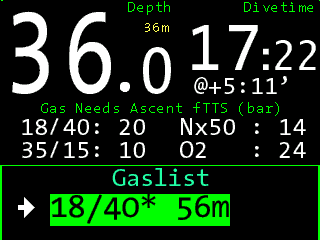

- the big layout display got a new dive menu with larger fonts (Preliminary in this version):

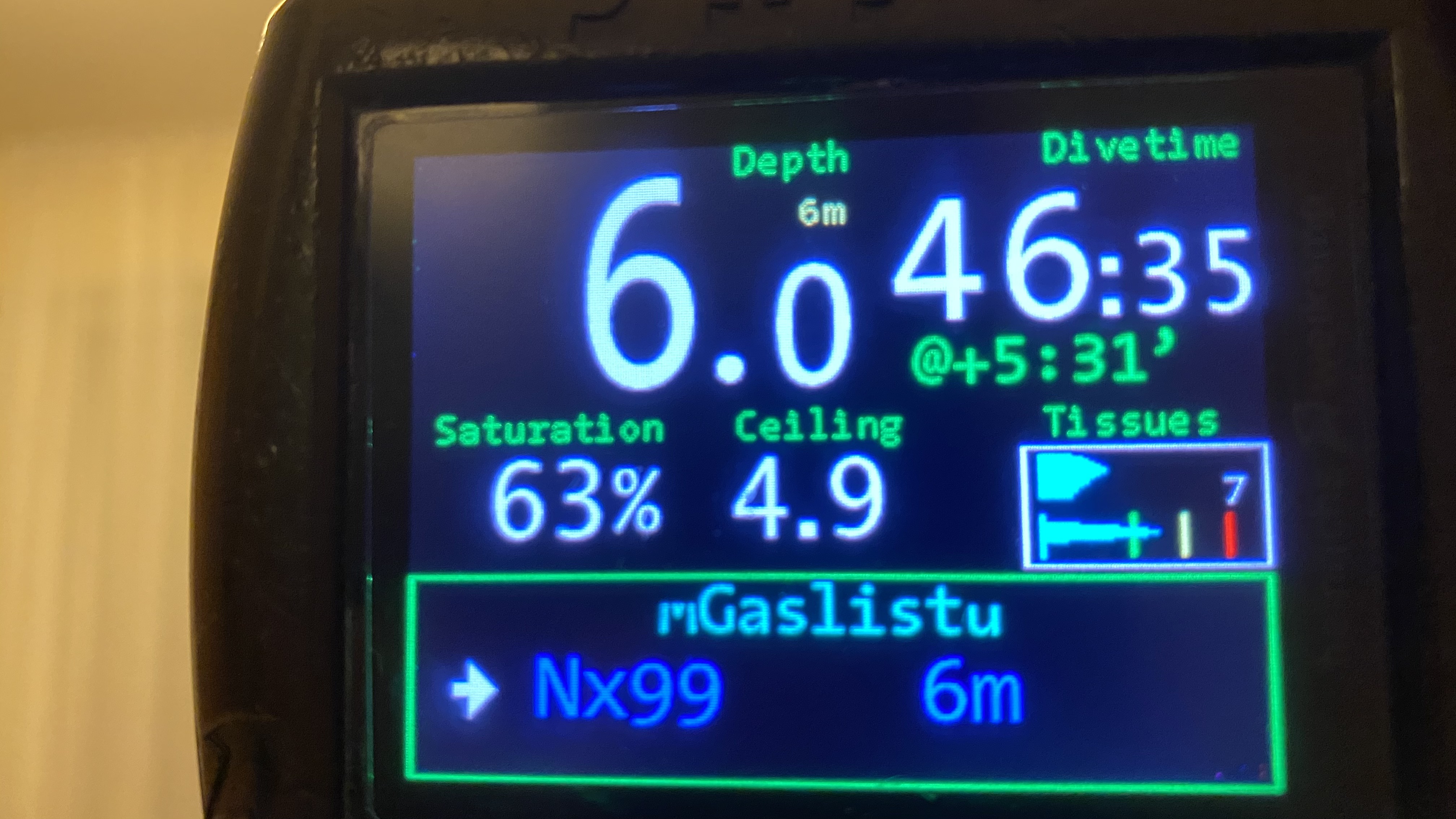

did a dive and played a little bit with the Simulator. Big fonts are nice, and Gas change (to deactivated mixes) with updated deco plan is more intuitive now. I discovered only two small layout bugs on my OSCT2...
1) With a leading tissue >9 the box around is overwritten
2) When going going do Main Menu --> Gas list some "ghost letters" are visible...
algo
