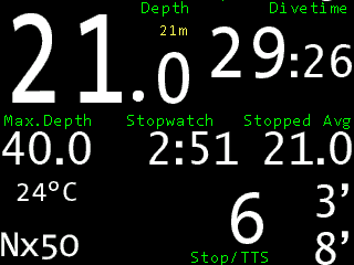

I'm running the large display settings due to deteriorating eye sight.
Can the gas switch view be made bigger in a next release?
Or create an XL display setting with an even bigger font size for both the standard dive screen and the gas switch view?
(running tech os 3.15 on ostc plus)

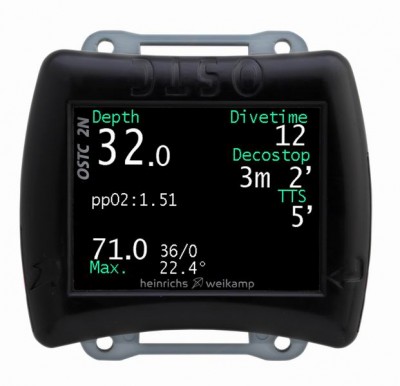

i dont like the layout of the large display neither... i can read the display of my OSTC 2N (10 years old!!) better then the display of my new OSTC 2...
in my opinion there is a missmatch of the size between large and small text...
Posts: 4459
Joined: Sunday 13. May 2007, 18:07
Re: large display setting -> bigger gas switch info
scubatinoo wrote: Wednesday 12. January 2022, 17:58 in my opinion there is a missmatch of the size between large and small text...
Can you describe this in more detail? The small (Tiny Font) text is only static, like "Depth", "max. Depth" or "Divetime". It's not really required to read this at all ambient light conditions once you are used to the unit.
Here is in comparison a 2N dive mode screenshot:
The static descriptions require more space but the font size is pretty much identical.

[quote]It's not really required to read this at all ambient light conditions once you are used to the unit.[/quote]
Yes, but to get used to the unit i should be able to read the small fonts :lol:
I'm quite sure that i can read the large fonts if they are a bit smaller, and the small fonts better when they are a little larger... If you compare the two display (2 and 2N), the 2N looks more... balanced?

I tend to agree with scubatinoo. The 2N layout looks tidier (aufgeräumter). But maybe its just age. LOL

Hi Matthias, thanks for having a look.
My issue is mainly with a manual gas switch.
When I'm doing that I'm just interested in the depth and the list of gasses I'm selecting from.
So maybe the choice menu that is presented at the bottom can have a bigger font if you are using the "large" screen layout?
Or a vertical list spanning the right side of the screen?
