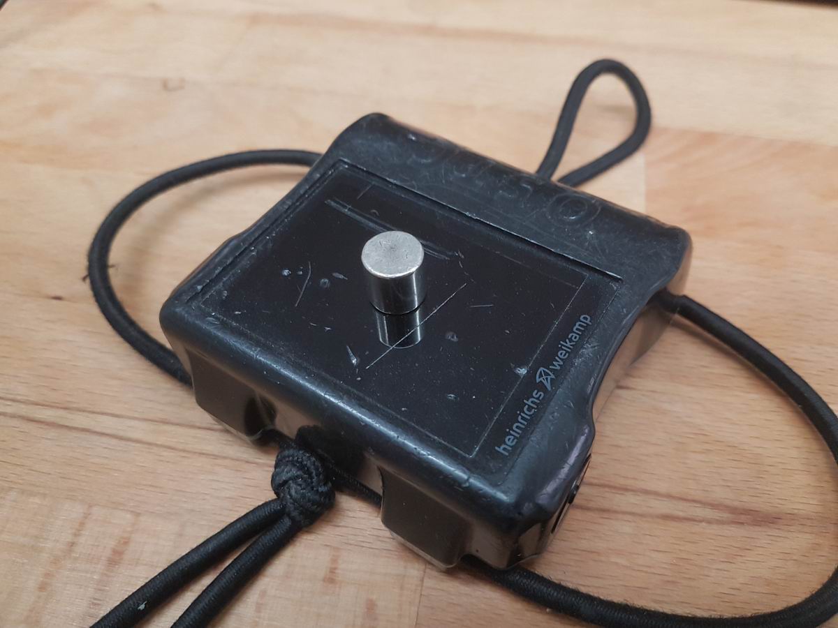

I belive it's ok now. I've to use a very powefull magnet (so strong that it stick on the computer). I put it on the charging pad. It turn constant green and start charging. I let charge up to 20% this way. Then i remove the magnet and it continue to charge normaly (blinking green) until full (99%). It was very hot during charge about 35°C according to display. 3 days after this charge it still turning on normaly, indicate battery 98% and 4.1v (before it was more 3.1-3.4v). I've maybe an opportunity to dive this weekend and try. (Don't wooried I still have a loyaal MK2 as backup this one has no issue)
- Posts: 4535
Re: Battery completely empty
Thanks for the feedback. It's really just a reed switch on the PCB, no need for a monster magnet or so. 35°C is normal.

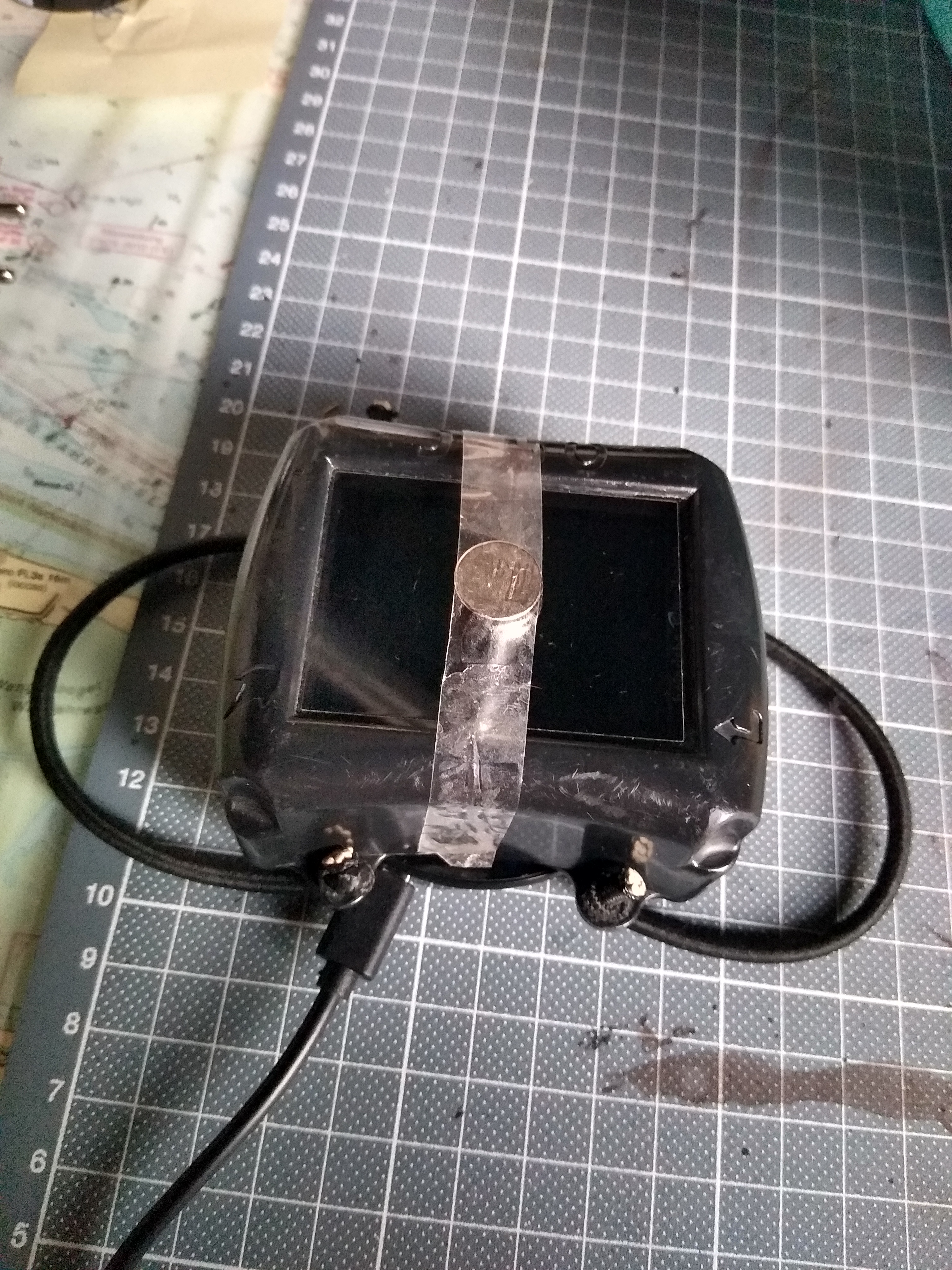

Im having the same issue.
How long did you have to leave the magnet on?
I've kept it on mine quite a while but nothing seems to be happening.... I had to tape the magnet on the display, as it otherwise would immediately slide of to one side...
Is this placement correct?
Thanks for your help!

- Posts: 4535
Charger is active and showing that it's charging? This only works when the battery is charging.
A few seconds is usually enough. Try the position by moving the magnet around if it does not start right away.

Hi Matthias,
Charger indicator blinks a few times when plugged in, putting the computer on the pad, the indicator turns solid blue.
Computer and pad are warming up, so something seems to be happening.
I'll try moving the magnet around tonight again, maybe I didn't leave it in place long enough when moving it around.
Thanks.
