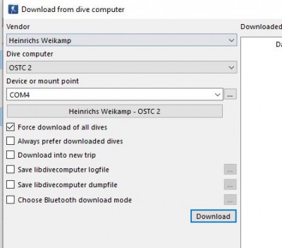

After downloading release 3.15, I decided to download the dive I did this morning with 3.14 beta 2 (yesterday dives already downloaded before) : instead of the last dive, the almost the full logbook was downloaded (about 200), until the transfer crashes. Not a big problem, if it occurs only once.
Regards.

I also used today and same thing happened, downloaded over 140 dives.

Box "Force download of all dives" ticked?

Hi guys,
No, I did not check the "Force download of all dives" box. Anyway, today only the new dives were downloaded (two CCR dives, nothing to signal about 3.15).

in subsurface you can always check/uncheck the dives to download. so, if you don't take a look at what you'r doing something like that can happen. I don't think it is an OSTC issue - my peregrine shows the same behavior in subsurface-mobile. but I will test my OSTC this weekend.....

dadefay wrote: Wednesday 26. May 2021, 21:23 No, I did not check the "Force download of all dives" box. Anyway, today only the new dives were downloaded (two CCR dives, nothing to signal about 3.15).
Thanks - I'm pretty sure this should be fine now. We made no changes whatsoever here.

Box to download all was not ticked. It takes a long time to just get the list, then you can unselect all and select the one/s you want.
This has happened before after an upgrade.

hi all
tested it right now....
connecting my OSTC+ to subsurface without checking the box "force download all dives" all dives of my OSTC are marked to download or as "new" dives (tested it in subsurface desktop AND mobile - both the same). easy solution - just klick on "deselect all" an mark just the dives you want to download -> done. quick and dirty.
I gonna post this issue in the subsurface-group, 'cause I think its not a HW-issue...

still waiting for a response in the subsurface-forum (dirk seems to have some "bigger" issues than that) but I did some dives in the meantime - and this behavior didn't show up again.
it seems to me, that subsurface recognises the new firmware and so all dives are "new" ones, but this happens (on my devices) just the first time after the firmware-upgrade. nothing to worry about.....
