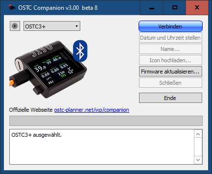

OSTC 3, sport, Plus, cR and the OSTC 2 are updated with the OSTC Companion software:
Download the latest version here:
MAC OS: https://www.heinrichsweikamp.net/downlo ... _3.0_8.pkg
Windows: https://heinrichsweikamp.net/downloads/ ... _3.2_1.exe
Latest 32Bit-Version: https://www.heinrichsweikamp.net/downlo ... 0.21.1.exe
To upgrade, download and unzip the latest firmware for your OSTC device:
Firmware
- Pair (Bluetooth only) your OSTC to your PC/MAC.
- Setup Communication port in the companion (Small gear icon next to computer list)
- Click on "Upgrade Firmware..."(Without clicking "Connect"), browse to the unzipped firmware HEX file and click on OK.
Wait about 1min - Done.
