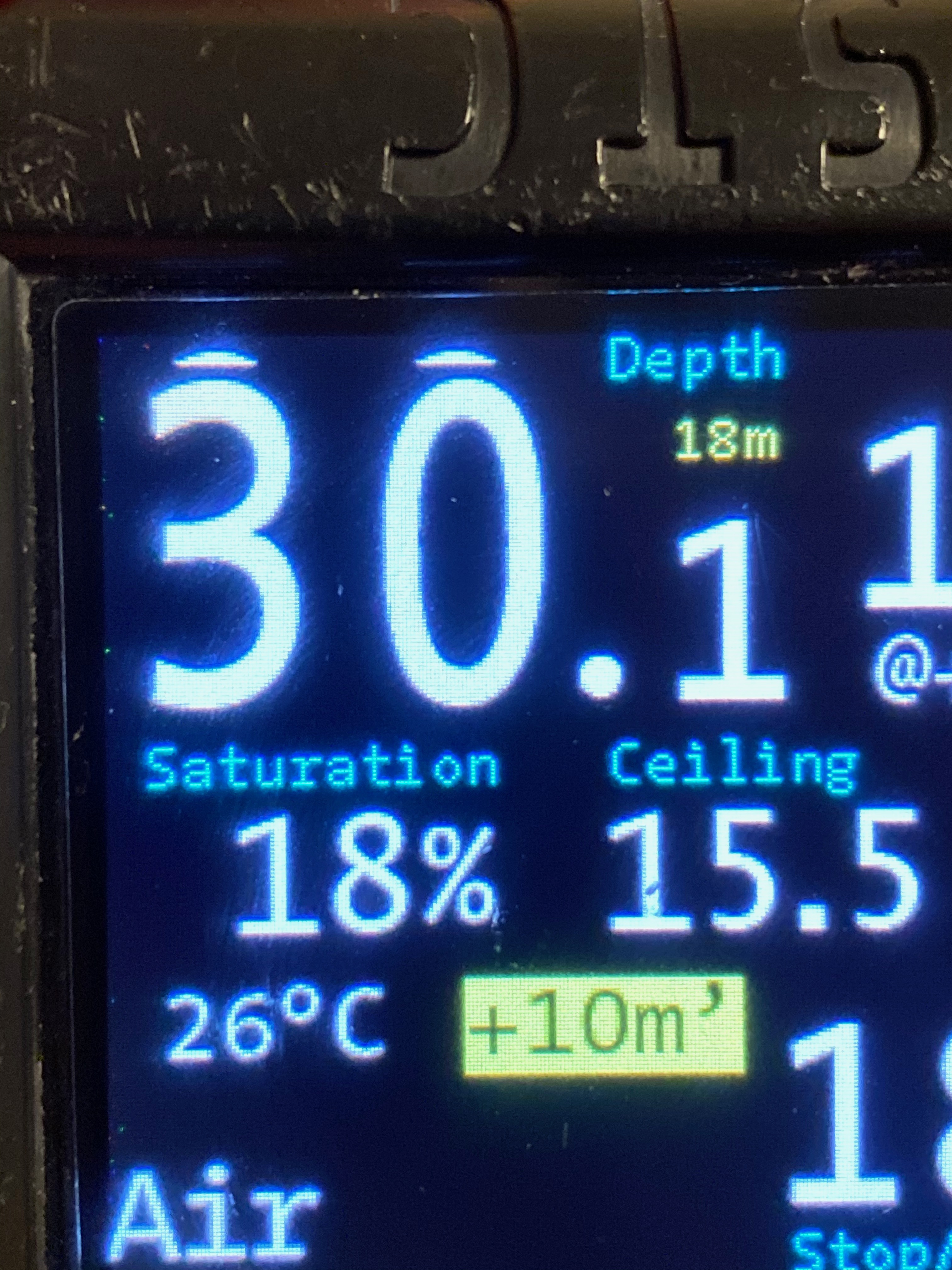

I just played a little bit with the simulator (3.09 beta 2). With the big font layout it now shows at my OSTC2 from the beginning only "NDL 0" and this doesn't change until deco obligation is reached... from there on first deco stop and tts is shown as usual...
Re: hwOS Tech: Version 3.09 beta 2 available
With a simulated dive to 100m the screen ended up with some "garbage" in the upper left corner after the depth changed from xx.x to yyy. See attached picture from ascend..
[attachment=0]IMG_0526.jpg[/attachment]

Bugfixing Information:
NDL always showing zero: that was a simple but stupid bug in the output routine that came in on fixing another bug, annoyingly.
Garbage in depth output after crossing 100m: the mechanism for such ghost outputs is a known one, though the individual trigger always a little bit hard to find. I'm on it...
-------> Update: all fixed, await V3.09 beta 3 <--------
