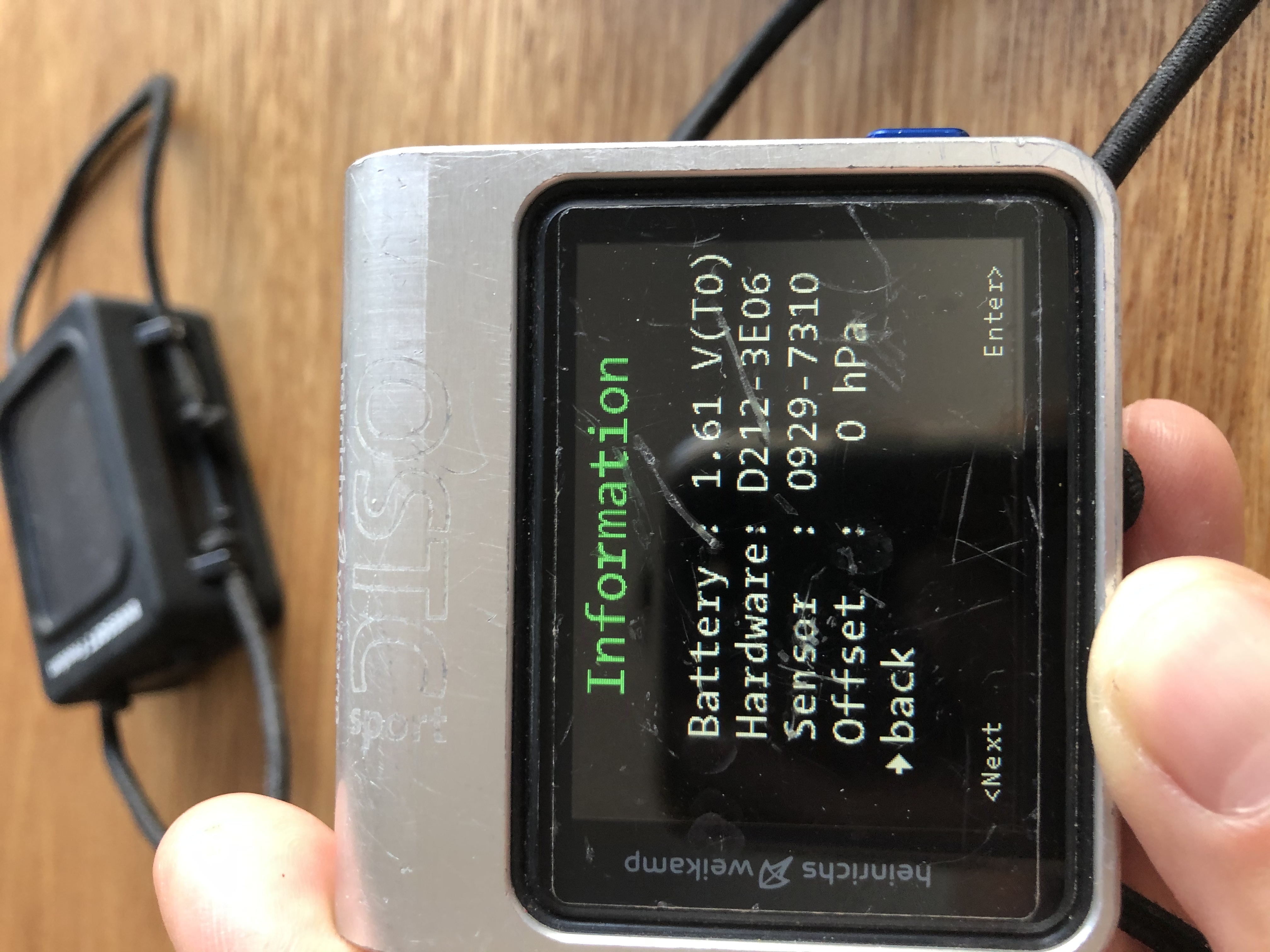

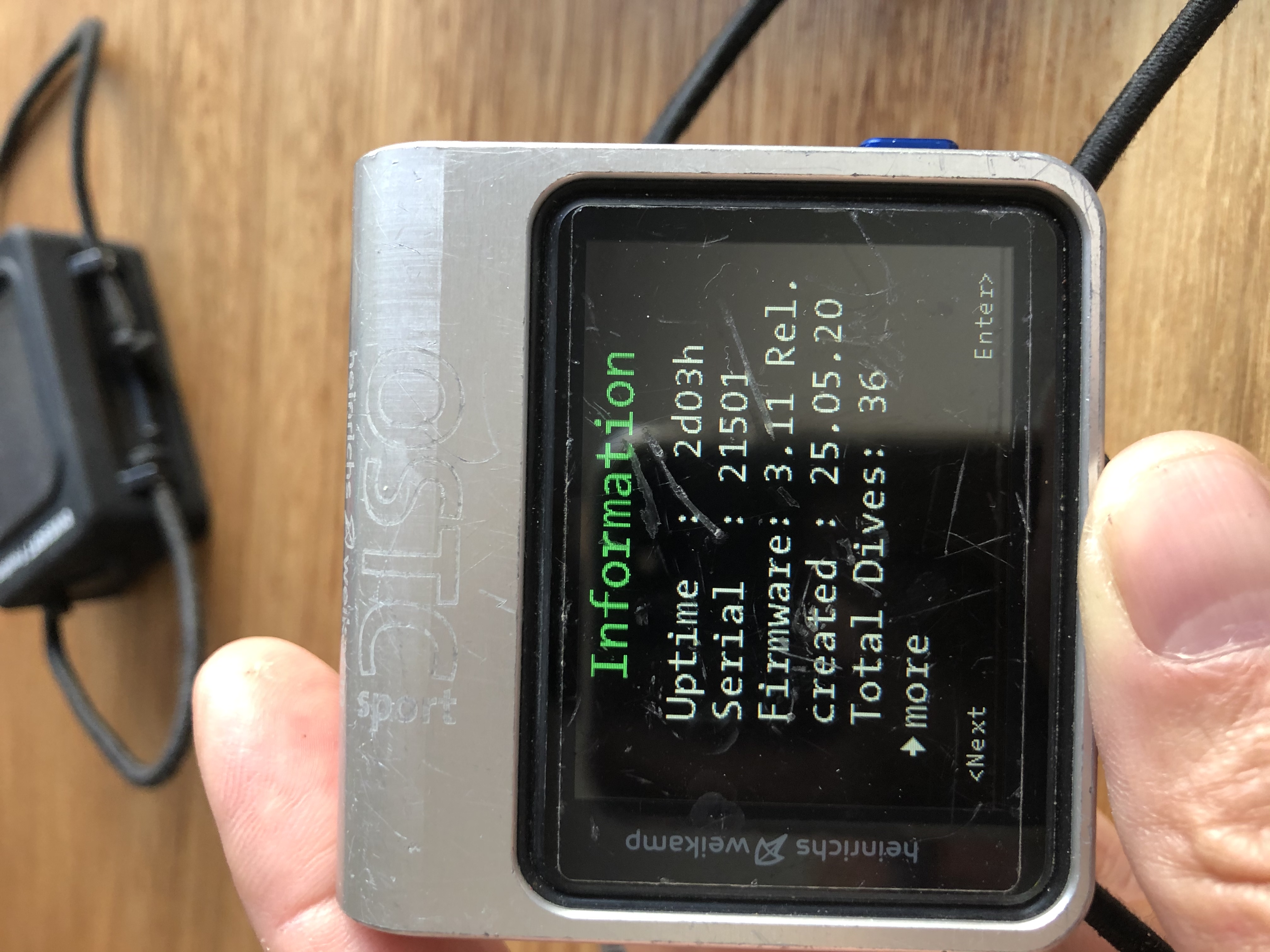

Here is the data I could find
The strange thing is that the dive and the one after the restart is not in the logbook

There's one kown bug around reboot during a dive posted here on the forum, but it involves a specific combination of TR model and compass operation. But that's both not the case with your incident, so it is most likely what Matthias already suggested: contact problem with the battery. The software version you are running has no record of instantanious reboots.

As far as I understood it (please correct if wrong): this device calculates the % display from the voltage. Some other OSTCs have a charge counter built-in (OSTC plus, 4) and show the % as a remaining charge. So the % display looks the same in OSTC plus and OSTC sport, but the meaning of the % number is different (sport: voltage, plus: remaining charge), and it's not mentioned in the documentation.
The pictures above show 1.61V and 67%. This doesn't fit together, 1.61V should be 100%, and 1.37V should be 67%. But it could happen if the voltage temporarily dropped because of a bad contact; for a split second it dropped to 1.37V, the % dropped to 67% and stayed there. The % display doesn't go up again when the voltage goes back up to 1.61V.
