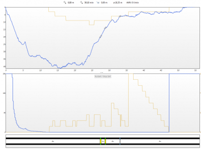

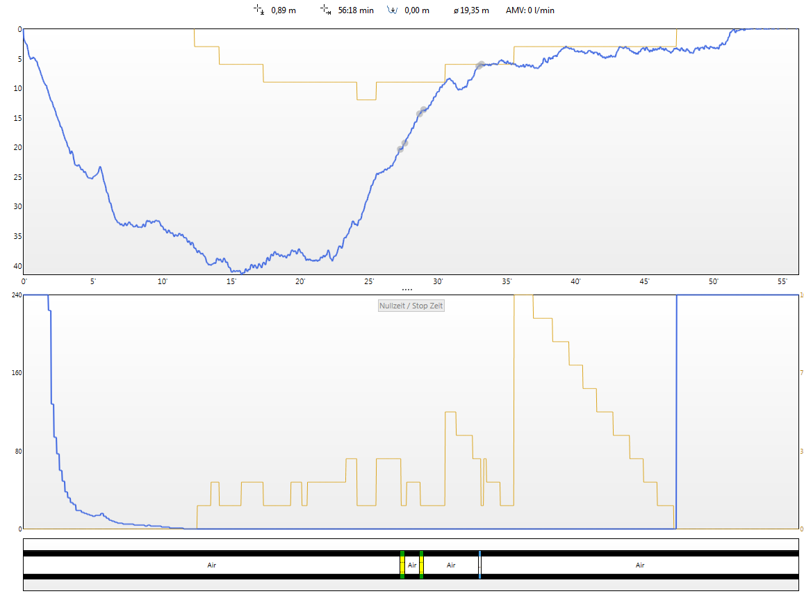

Re: TTS bei deaktivierten Dekogasen, Bug?
Post by heinrichsweikamp3 »
Ralph provided a simple change to get this feature back into the OSTC code. I tested this on two dives last weekend and we'll include this in the next versions for the hwOS sport and hwOS tech.
You can see direct response of the TTS for several gas switches I entered into the OSTC during the ascend and deco phase.
