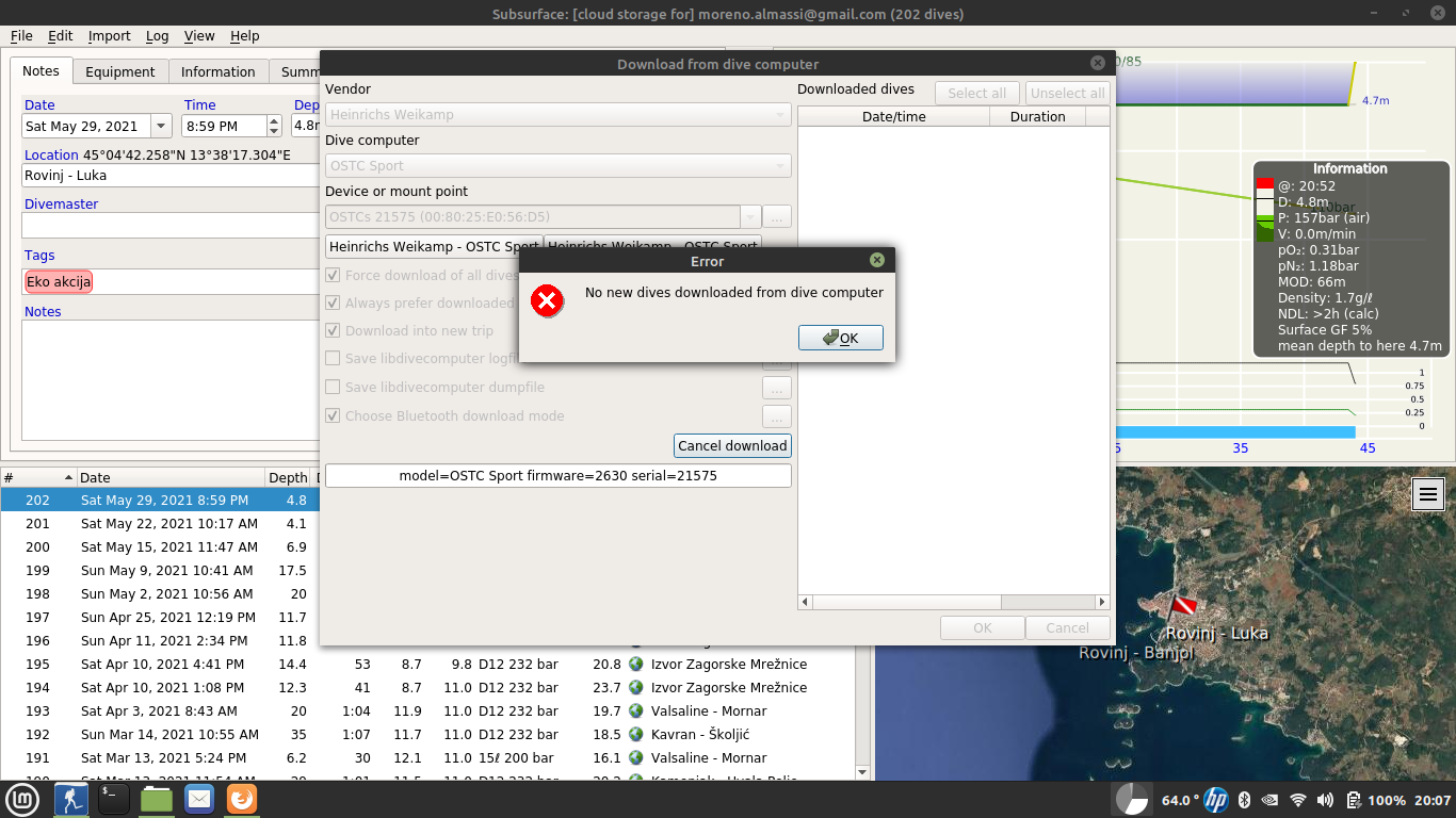

After update with 10.70 i had 2 dives.
The diving computer works fine but I cannot any more transfer my dives to Subsurface.
I try to transfer with Subsurface on mobile phone, Linux and Windows without results just the message:
I try to transfer on DivingLog 6.0 with same result.
I managed to download libdivecomputer logfile and dumpfile (I can send the link to download).
Please help.

Hi!
After a complete dive log reset everything works fine.
OSTC Sport #21901
Pula, Croatia

moreno wrote: Tuesday 1. June 2021, 15:31 Hi!
Thanks for the feedback. Here I really don't expect any issue in the OSTC firmware. There were no changes reagrding this and we did not see this behaviour on our own units.
Regards,
Matthias
