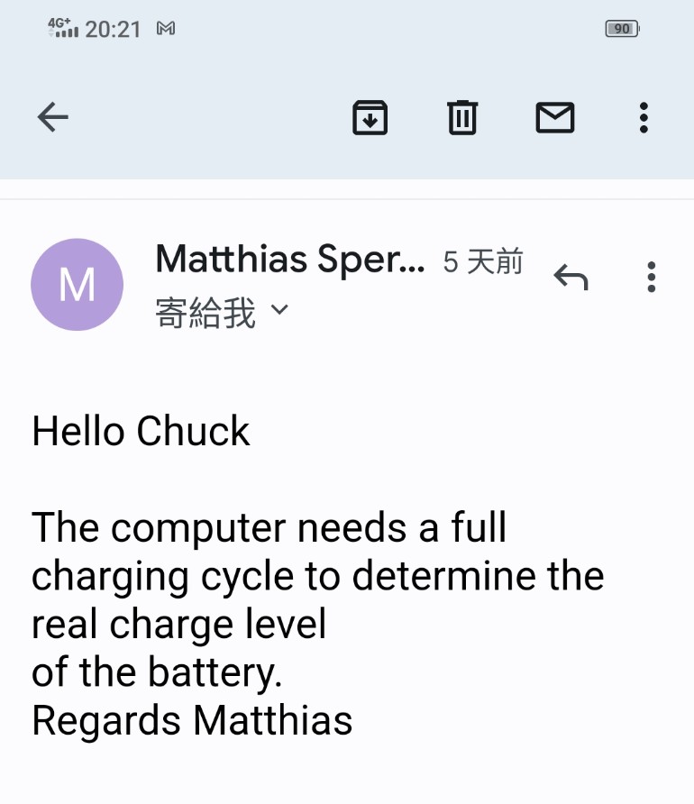

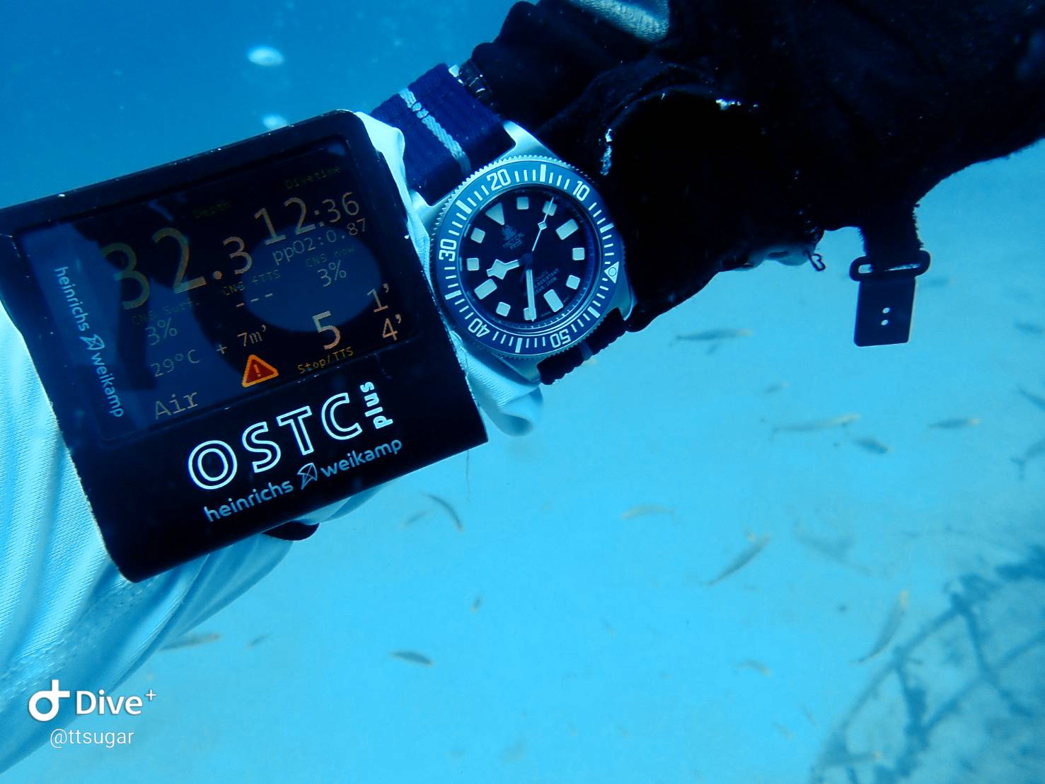

This is what I was told, everytime I replaced a freshly charged 3.7v 14500 battery, dc always shows 0% battery power and with the warning sign. Meaning I need to bring the charger on every dive. Quite a pain for me.
Posts: 4511
Re: OSTC sport battery level
The OSTC plus (Not Sport) you have is intend to be used with the rechargeable 14500 AA Battery (3,6V LiIon-Battery). The battery will be recharged inside the unit using the wireless charger provided. 1,5V batteries can be used, but this more intent to be an alternative in the event that the battery e.g. on vacation gives up or no charger is available.
As written in den manual (P.44), the batteries are intentionally shown as 0% when inserted until a full-charge cycle happened. Only then, the firmware knows what capacity to expect from the battery and can provide a reasonable %-battery reading.
Hope this helps.
