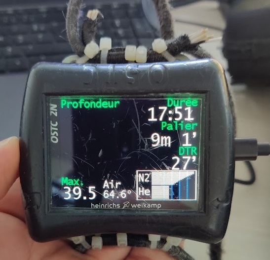

In a dive, the OSTC didn't start and and the LED below the brand name is not blinking.
The OSTC only started when I plugged the USB cable. It showed the screen in dive mode buth without the current depth.
Then, I rebooted the OSTC with the magnet and it showed this screen :
The OSTC showed the main screen but with bad air pressure and air temperature.
After few minutes, the screen switched off and it was not possible to turn on. The only way is to unplug and plug again the USB cable.

Quite obviously a defect in the pressure sensor. We still have (few) spare parts for the 2N and are still repairing them. Just get in touch with us: info@heinrichsweikamp.com
