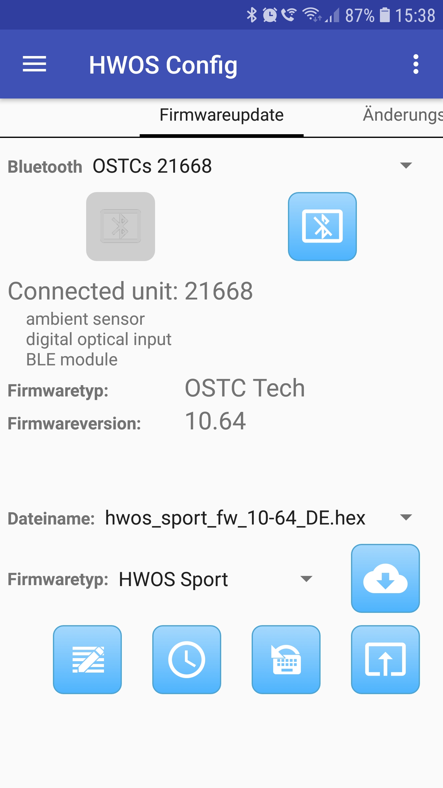

HWOSConfig for Android! Another very simple Method on updating the OSTC with an Android device.
What is implemented:
-Personalizing (setting of Customtext)
-Firmware update for HWOS OSTCs, Tech and Sport.
Supported OSTCs:
-OSTC 2 (new)
-OSTC Sport
-OSTC 3 (April 2015 and later)
-OSTC plus
Permissions:
the App needs
-Read/write access on the device
-Bluetooth access
-access to the internet.
There are no ads, and no data where collected.
Step by step instructions:
Install the App from Google
https://play.google.com/apps/testing/eu ... hwosconfig
-Accept permissions (only once after installation
Select your OSTCType (HWOS Tech or HWOS Sport) and click on download to get the latest firmware.
When you wipe to the right, you can see the history of changes file, provided with the firmware.
-Switch Bluetooth on your OSTC on.
-Go to Android settings, search and connect your OSTC.
-In the App select your OSTC from the combobox (make shure Bluetooth is on)
-click "CONNECT"
The type of the OSTC will be automatically detected and set in the combobox.
-check the type of the OSTC in the combobox, if neccessary change it.
(my OSTC Plus with Tech firmware tells me that it is a sport version, but it isn't, i have to clarify this with matthias)
After connection there is a line shown below the Download Button that tells the Identity of the OSTC (type). Plus users can mail me, or post the line here, together with te type of ostc (tech or sport).
-make shure you have a firmware version selected.
-click on "UPLOAD"
-be patient :-)
Custom Text:
-Select your OSTC in the App
-Click on "CONNECT"
-Click on "CUSTOM TEXT"
-Set the text
-Click "OK"
-Click "DISCONNECT"
