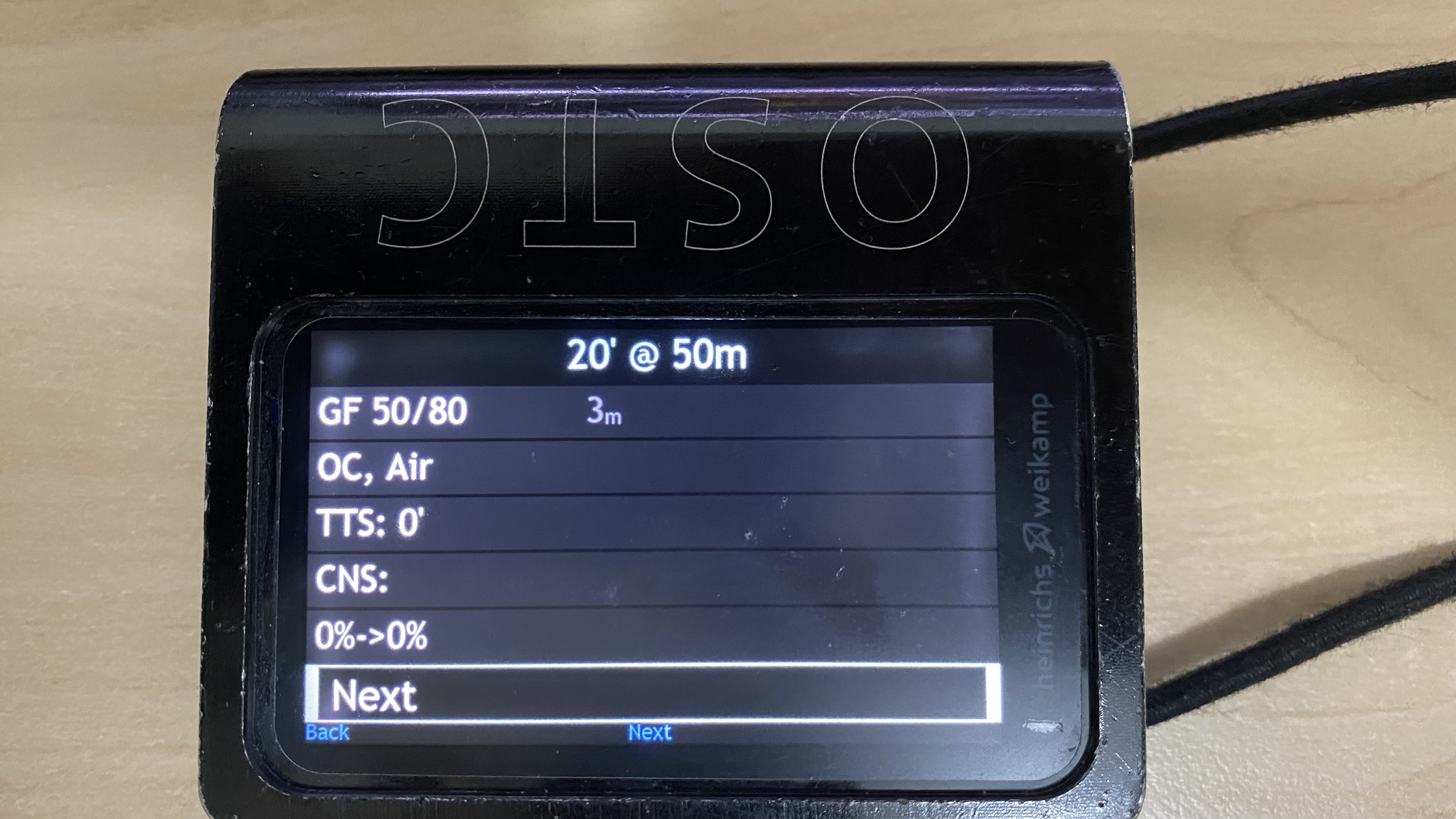

Hi, i found a strange behaviour of the Calculate Deco in the Sim Menu.
Going from Standby to the Sim Menu and press "Calculate Deco", it shows me no Deco at all. Regardless how often i do this, see picture IMG_4464.jpeg.

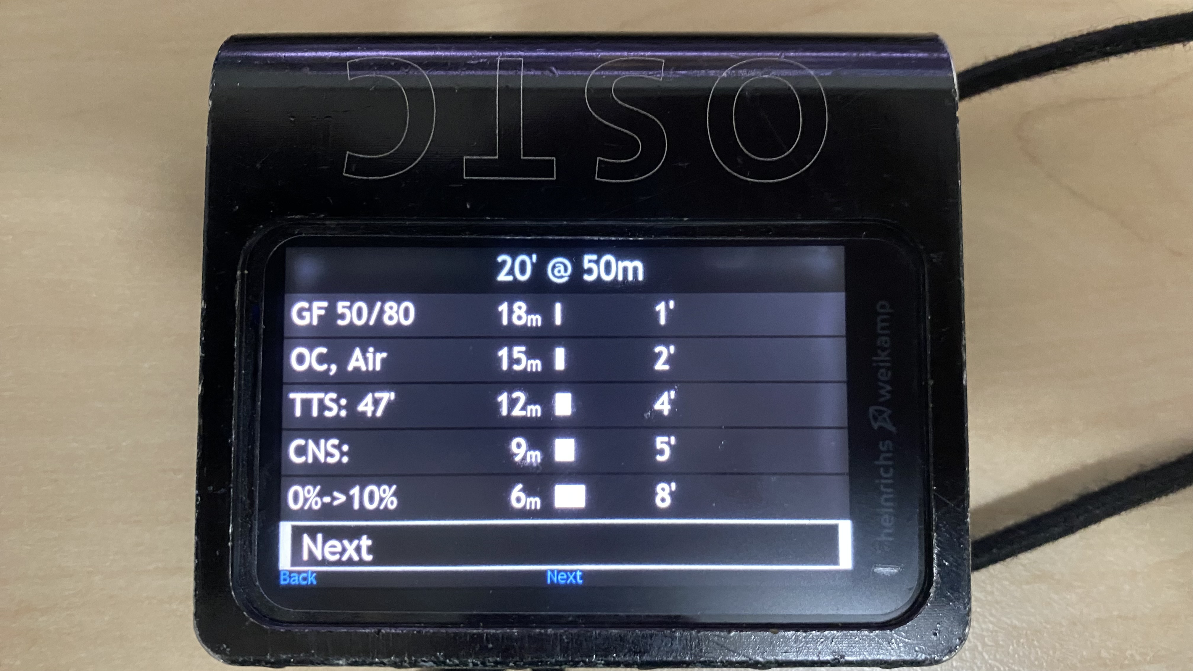

But if i then choose "Start simulator" and immediately terminate the simulation and try "Calculate Deco" again, i get the following result, picture IMG_4465.jpeg.
I can reproduce this every time after wakeup from Standby. I don't remember having this behaviour before. Only thing i did is replacing the battery...
Re: Odd behaviour of "Simulator, Calculate Deco"
This is known issue of the 1.6.2 and is already fixed: https://code.heinrichsweikamp.com/publi ... 5f9557c053
We have a new release very soon.
