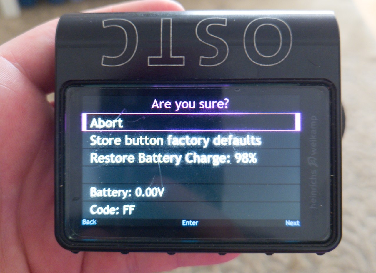

NEU: Nach einem Firmware-Update werden die Werkseinstellungen für die Tastenempfindlichkeit verwendet, wenn diese vorhanden sind, ansonsten die
ansonsten die Standardeinstellungen. Die Werkseinstellungen für die Tasten können über das Menü System /
Menü Reset / Wartung / 'Werkseinstellungen der Tasten speichern'.

NEW: After a firmware update, use the factory settings for button sensitivity if these exist, the
default settings otherwise. The factory settings for the buttons can be updated in the System menu /

Re: hwOS4: New Firmware 1.6.5 with RTE 3.20
Post by kuxaxak »
I update mine OSTC4 to 1.6.5 from 1.6.0. It was a bit discharged to 2.7V, I charged it to 3.3V on old firmware, then update it.
Now it show me 0.0V and in maintenance menu code FF. What does it mean?
kuxaxak
Posts: 2
Joined: 21 Nov 2021, 18:32
Post by kuxaxak »
Okay, it was my fault, I didn't flash RTE second time and it got a weird state. After flashing update one more time RTE got updated and now it is working correctly.
