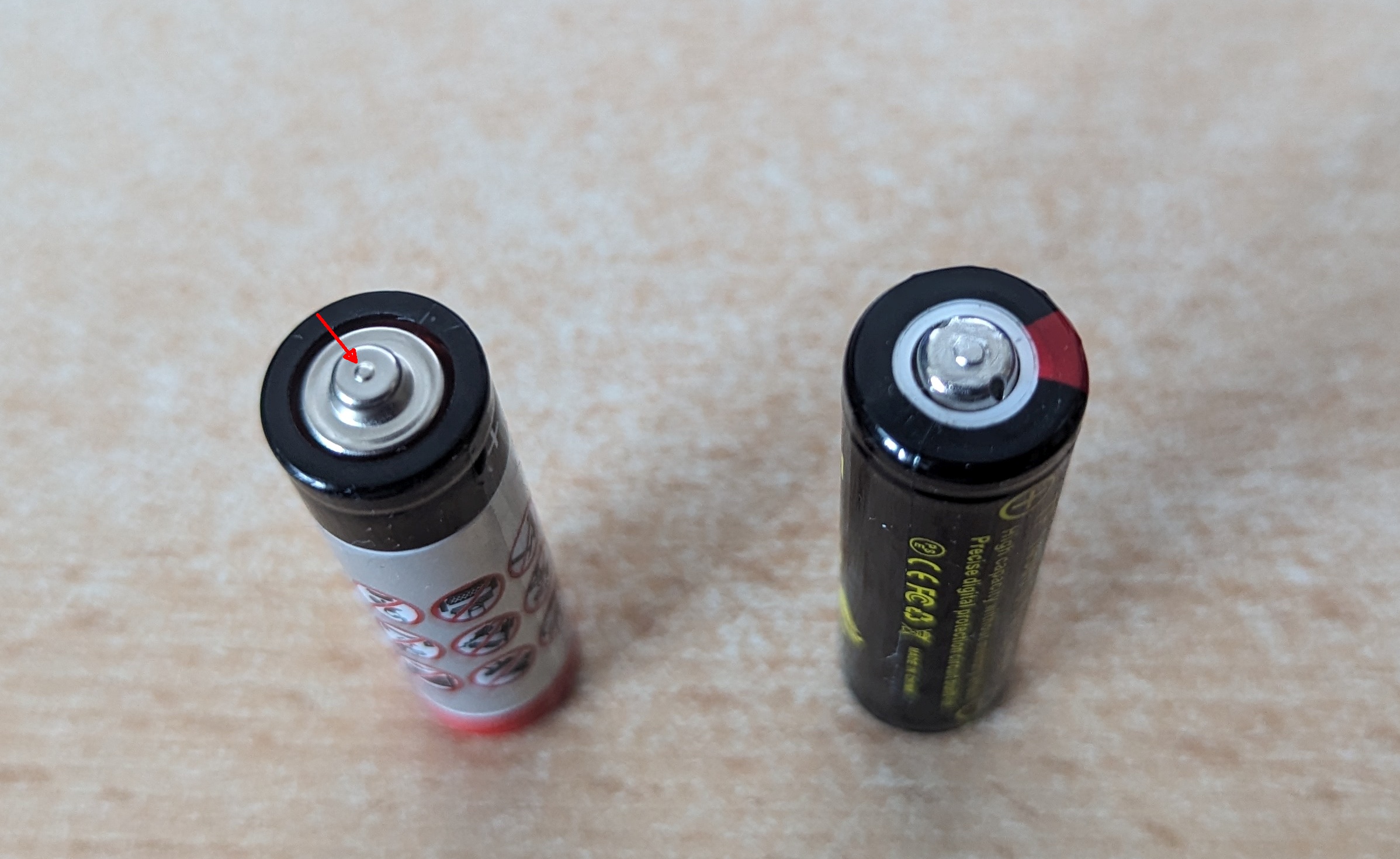

Yes your right it is a contact problem on the + side.
I tried different bateries and only one worked with a little tip on the top. So I tried soldering a small tip on the 3.7V Li rechargeable battery and now it starts.
Not sure if this is a good solution but I am going on a trip in 2 days.
The 3.7V Li battery is 1 mm longer than the normal AA cell, with the soldering tip it adds 0.5 mm more ... hope nothing gets broken when I close the battery compartment.
