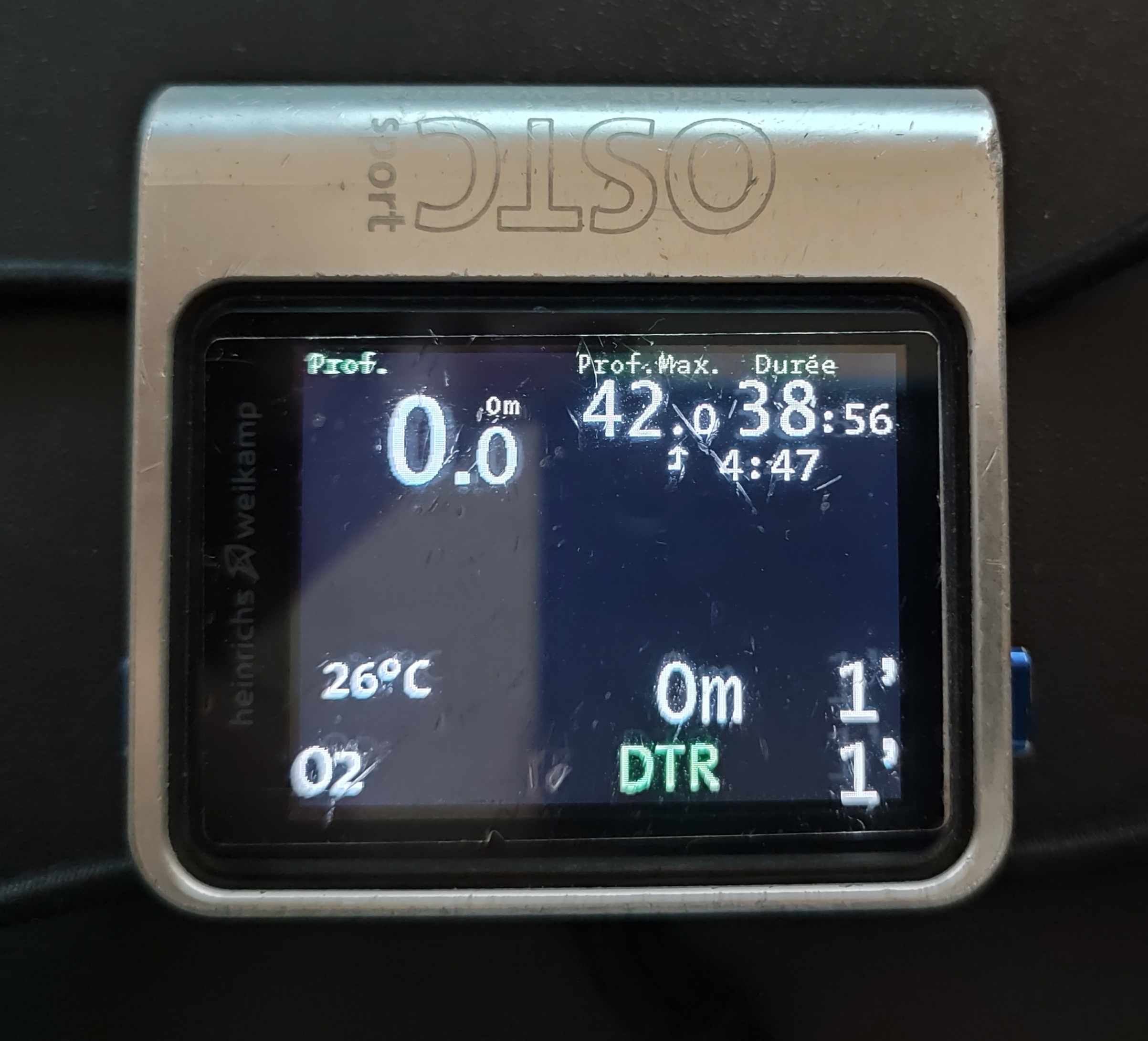

Good evening,
After the dive, when I reach the surface, the following information is displayed for a while:
- 0 m 1'
- DTR 1'
There's also a little arrow with a time under the total dive time.
What does this information correspond to ?
SW release: 10.80
Alain

Re: OSTC Sport - Need help about display
Hello Alain
The small arrow is the surface time after a dive in minutes. The settings on my OSTC is that it switch to the surface mode after 5 minutes. If I descent after this time again, it will log a new dive.
The deco stop on 0 m for 1 minute makes for me no sense. The DTR is the time to surface I think (I don't speek enough french to know what TTS mean in french :( ).
Hello Michi,
Thanks for your answer.
DTR means TTS, but I don't understand why it appears when I reach the surface. Like 0 m 1' !
The OSTC should not compute a deco stop on 0 meters. As the time is rounded up to full minutes, 1' could be anything down to 1 second and hence this whole 0 m - 1' a glitch due to rounding errors. Maybe the surface pressure has changed significantly during the dive, making the OSTC to belive the 0 meter stop is pressure-wise still a submerged depth. Will need to have a deep look into the code to see under which conditions such a calculation result may happen.

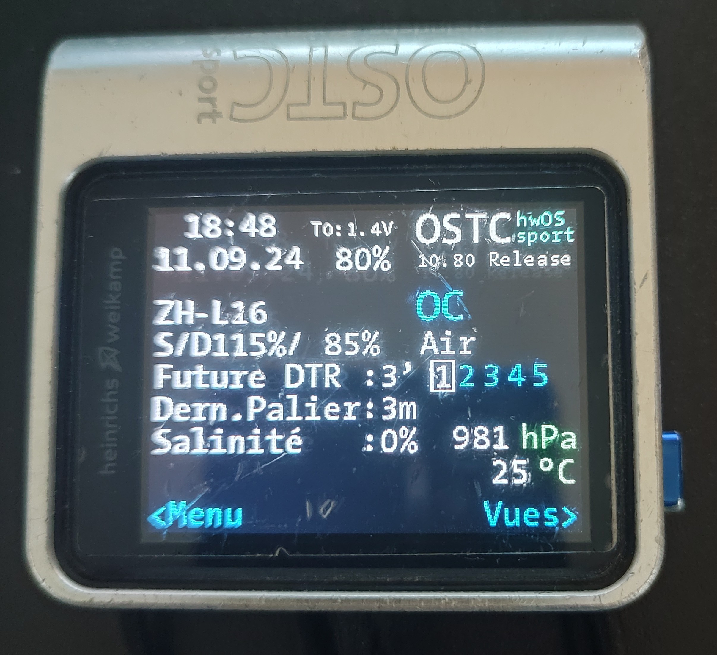

Here are the configuration settings:
[attachment=0]IMG_20240911_184604_cr.jpg[/attachment]
Whatever simulation or real dive I perform, after the dive, at the surface, the information 0 m 1' and DTR 1 are displayed.
In simulation mode, it is not necessary to perform the whole of the planed dive, if I stop the simulation in progress, the dive ends and the screen displays 0 m 1' and DTR 1'.
I think this behavior has been present since version SW 10.77.
Alain
