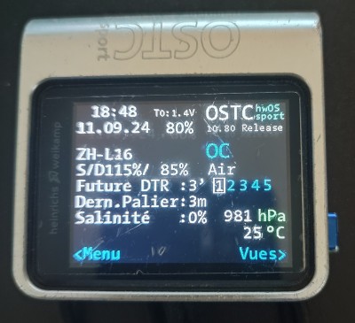

Here are the configuration settings:
[attachment=0]IMG_20240911_184604_cr.jpg[/attachment]
Whatever simulation or real dive I perform, after the dive, at the surface, the information 0 m 1' and DTR 1 are displayed.
In simulation mode, it is not necessary to perform the whole of the planed dive, if I stop the simulation in progress, the dive ends and the screen displays 0 m 1' and DTR 1'.
I think this behavior has been present since version SW 10.77.
Alain
Posts: 751
Re: OSTC Sport - Need help about display
We have identified the faulty line in the code that causes this erratic "deco stop at 0m" indication. It has no side effects can can be ignored. It does only happen if plain Bühlmann is selected, i.e. Bühlman without GF. The erratic indication can be circumvented by enabling the GF extension and setting the GFs to 100/100, which actually reverts the GF extension back to plain Bühlmann. The S/D factors will be regarded independent of the Bühlmann with or without GF selection.
