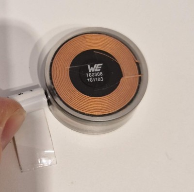

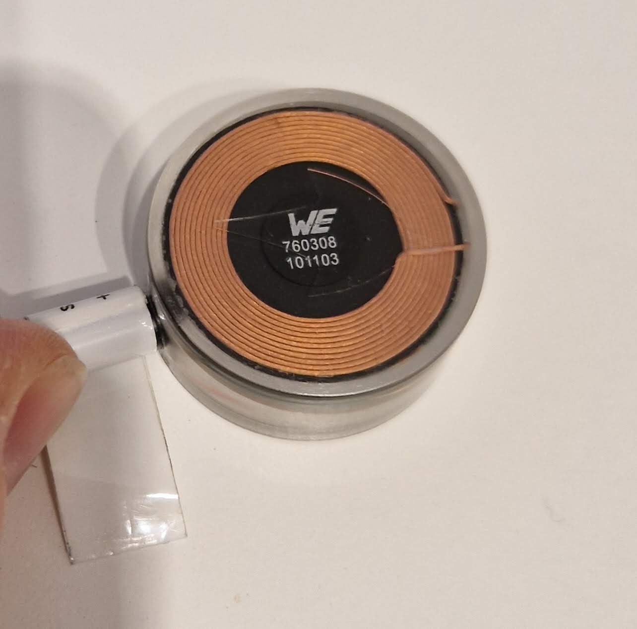

it takes ”forever” (practically a day or two) to charge my OSTC2. I’ve had this same experiece with two different units. I have measured the charging current using about 15 different dumb chargers with outputs 1,8A- 3A. With all of them the charging starts with more or less corresponding current, but after couple of minutes it drops to about 0,5A.
Is my charging pad faulty ? I have this one [attachment=0]20240808_071906_Original.jpeg[/attachment]
I got my OSTC2 a few years ago, and about the same time took a hiatus from diving unfortunately. So I’ve basically just been occasionally charging the computer back to life and only slightly cursing the charging speed 8-)

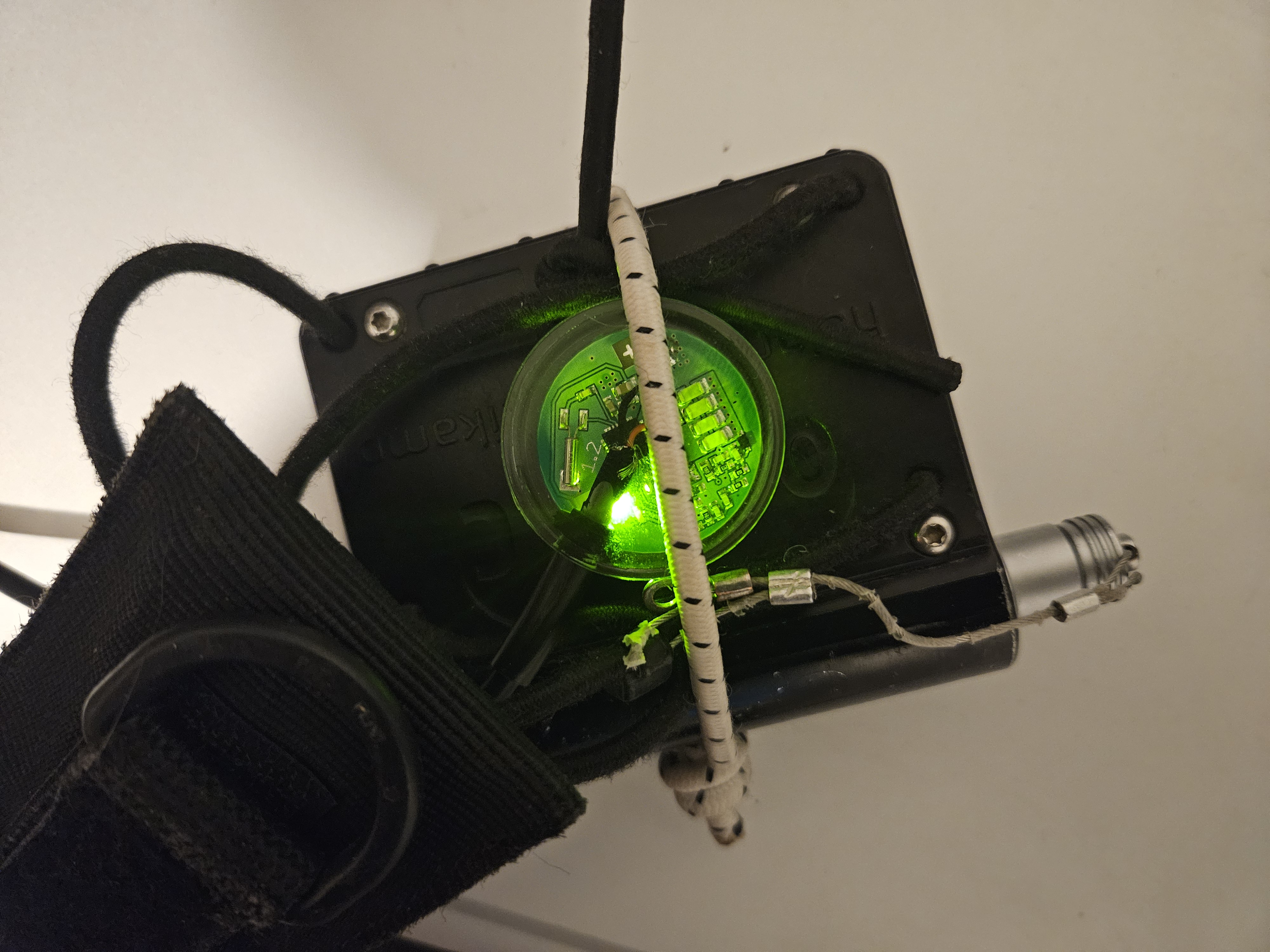

I keep the qi charger in place with bungee. Works perfect. And it has the advantage that the charger stays cooler = faster charging.
[attachment=0]20231116_204653.jpg[/attachment]
