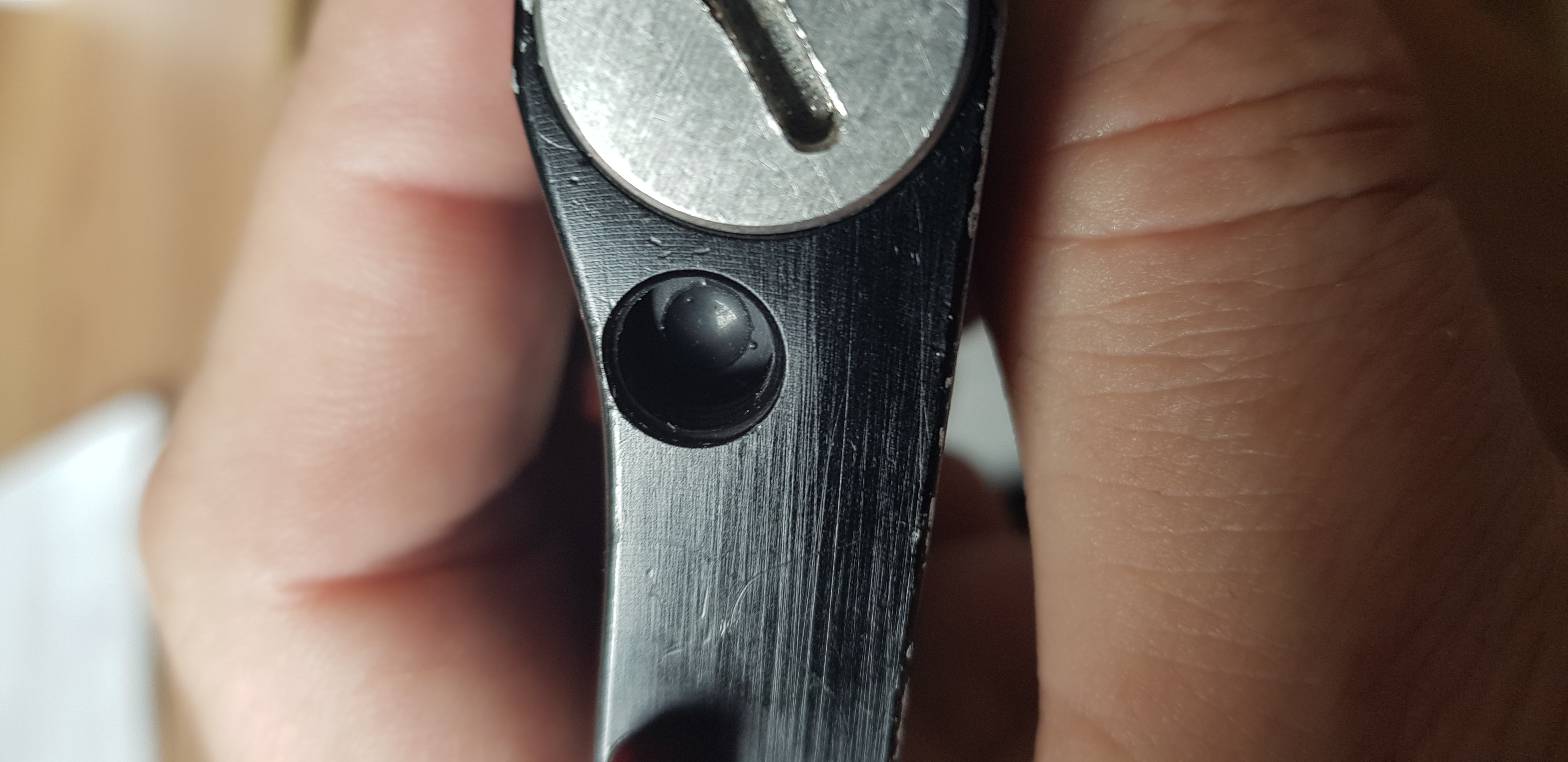

I only found an optical input.
Is that what you wrote about.??
I've never used it. I bought it used - and I don't even have such a cable..

sometimes the closer you have something to your eyes.. the less you see!
of course I found it..and I looked at it so many times...
I never opened it.. because there was no need
one more time..thanks for your reply

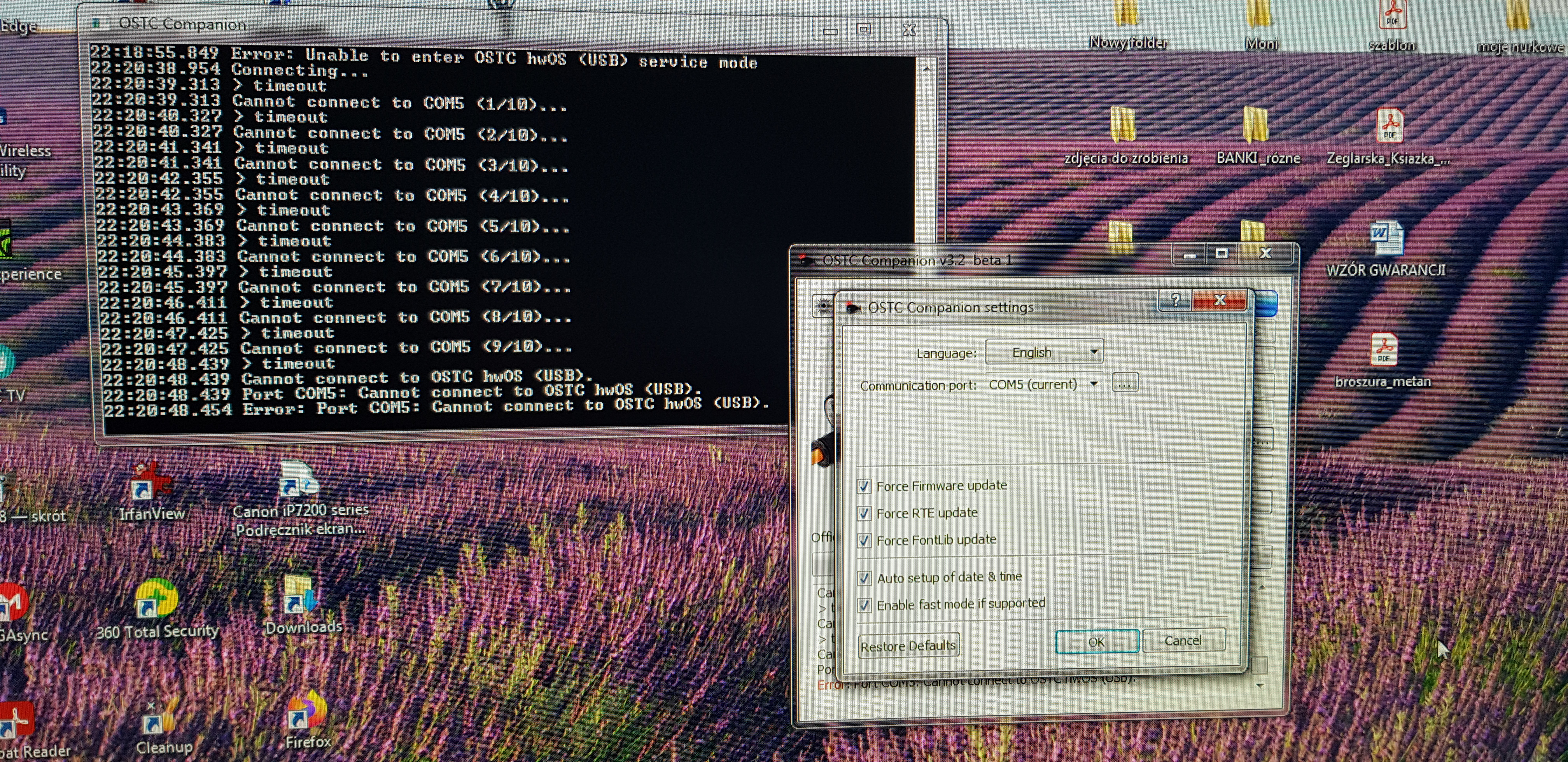

please help..
what am I doing wrong?? can't connect..i've been trying for an hour.
Did you do it??
Did you do it??

How sure are you that this particular USB cable can send data? I’ve seen some that’ll charge things but don’t send data.

Marcomet : are you sure your computer is connected to COM5 and not to another COM port ? Have a look to the Windows peripheral panel.
jb2cool : yes, this USB port is the only way to update the firmware and download dive profiles since there is no Bluetooth on this unit.
Regards.
Regards.

This is one of the cases where we have the exact same questions via email in parallel. So we send an email with some support here already.

Have you tried anothercable!?
