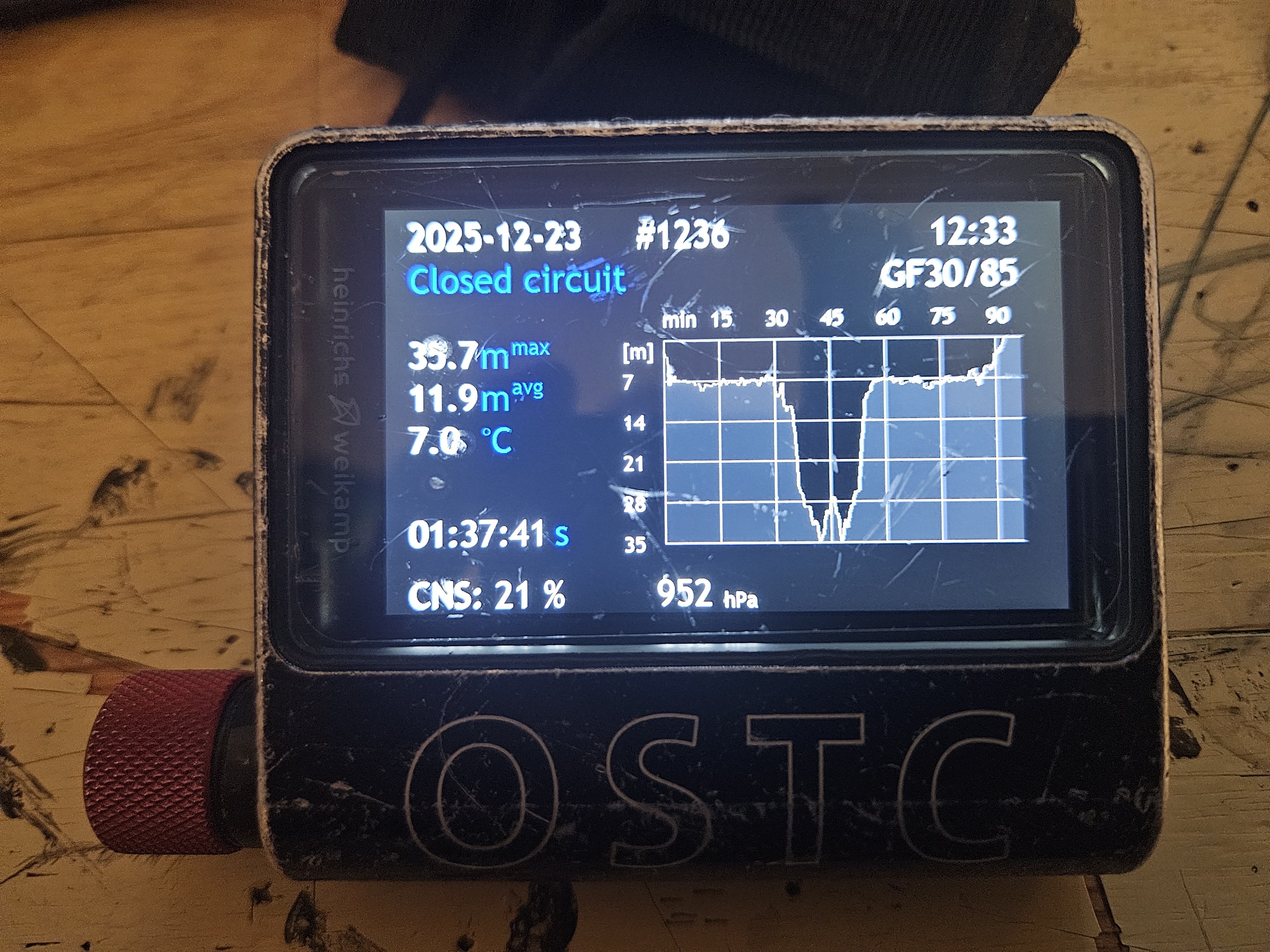

- Posts: 869
Re: 1.7.5 Beta with Surface GF
What seems to be missing is Surface GF in the Log entry. Would be great to have it.
