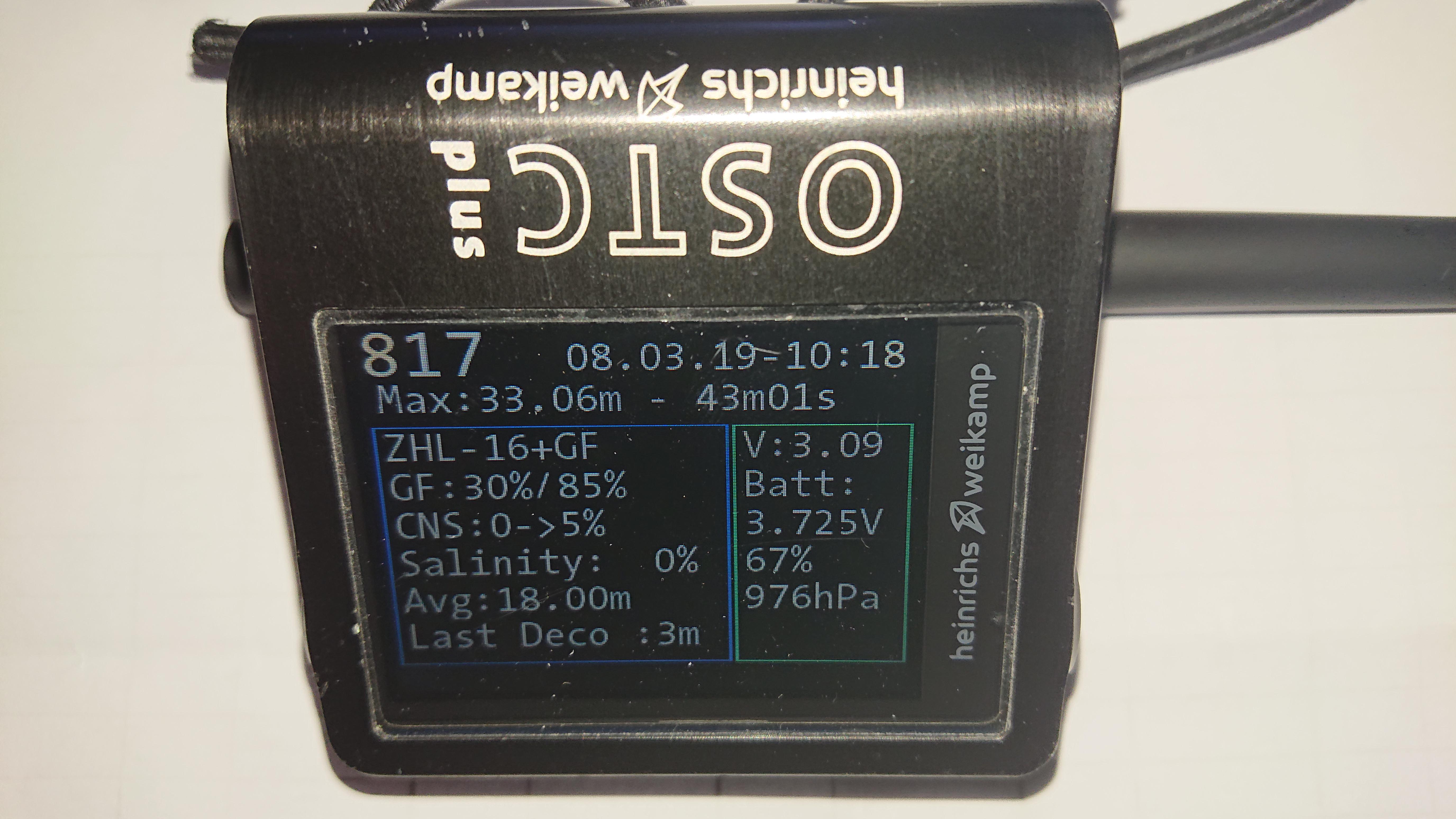

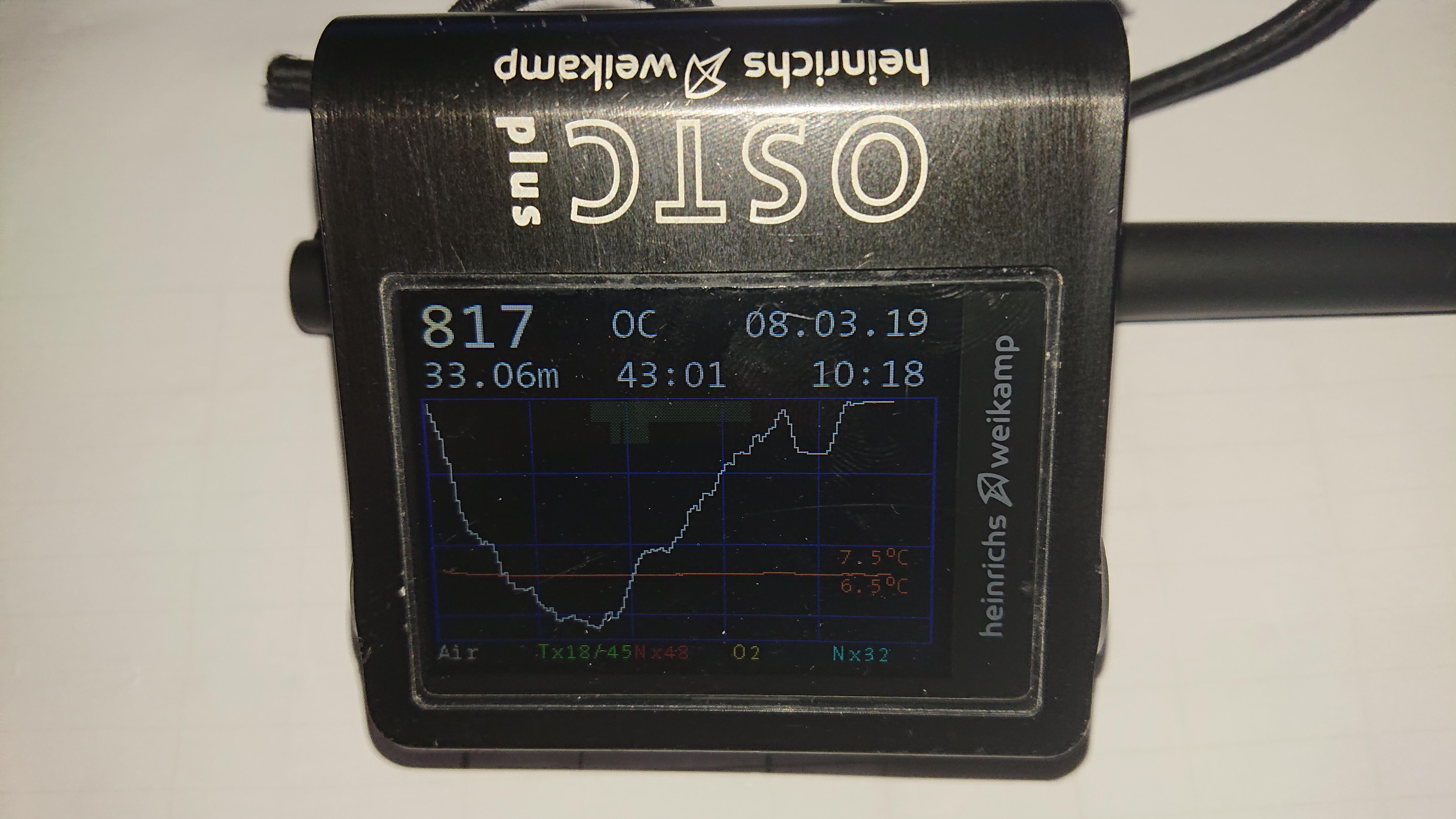

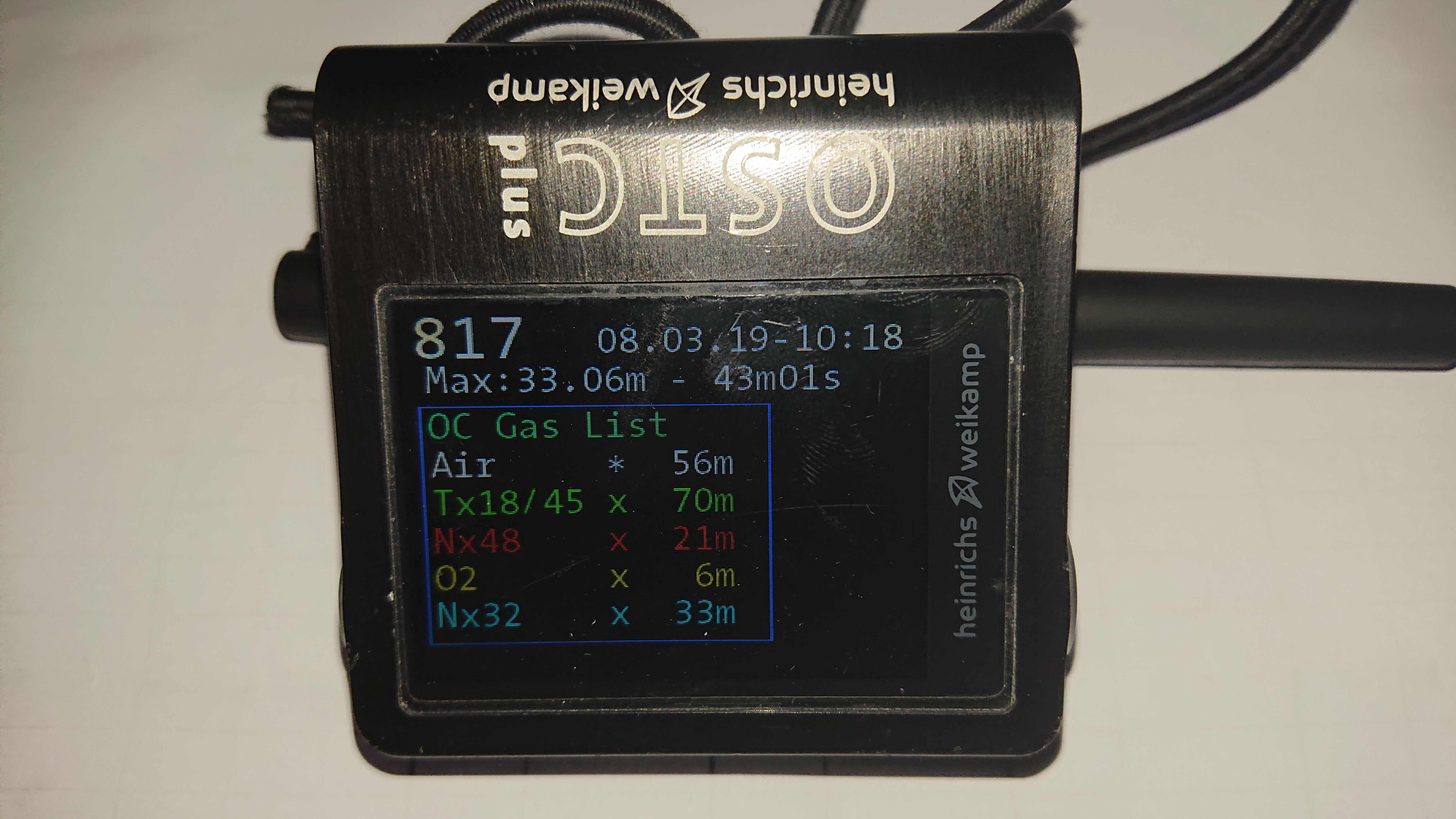

What does the OSTC built-in logbook show?
Re: hwOS Tech: Version 3.09 beta 3 available
Hi Ralph
The built-in logbook shows the profile, the page with properties and details of the dive and the gas list (after downgrading to V3.01).
Michi
OSTC 2C #7452
OSTCplus #17296
Michi
OSTC 2C #7452
OSTCplus #17296
Well, so on the OSTC everything is fine, but the dive data download failed!?
