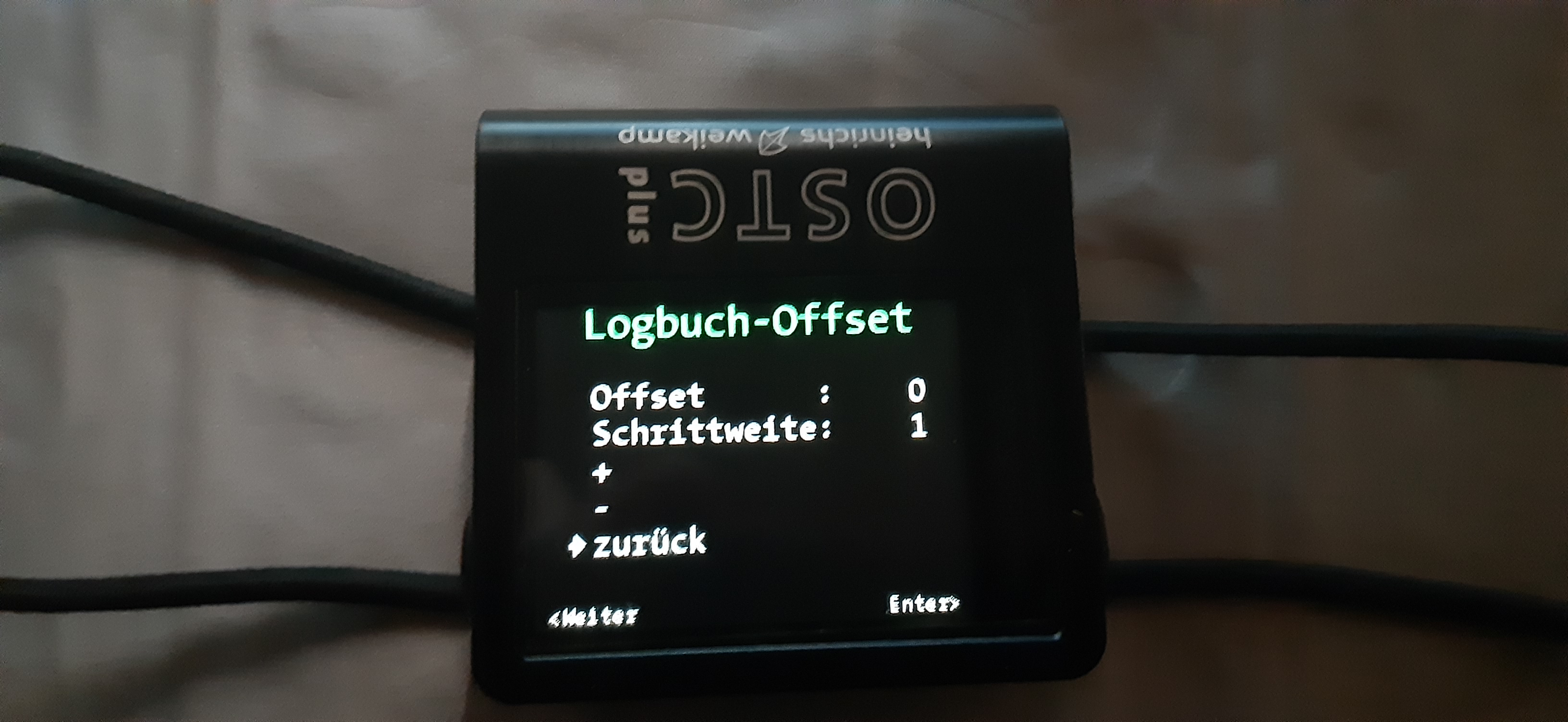

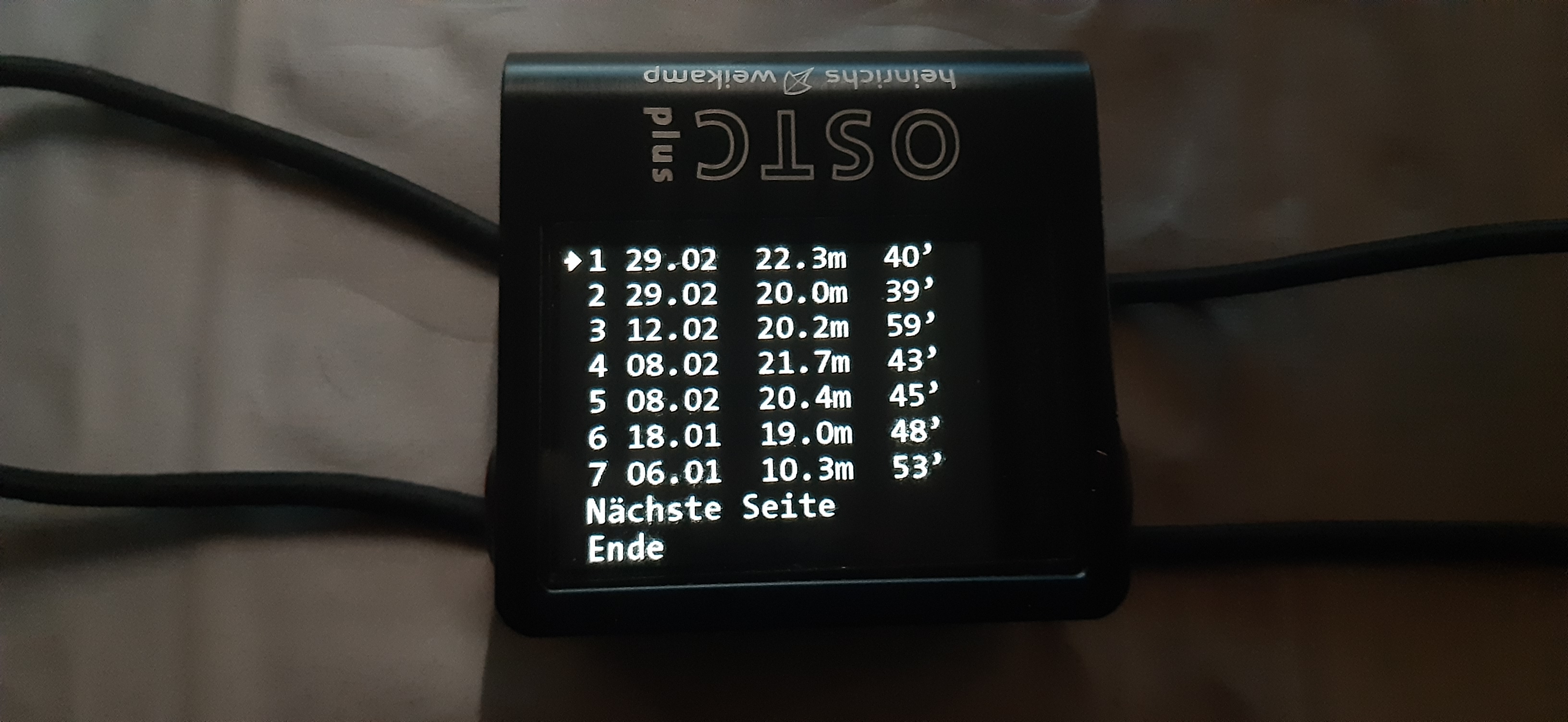

hi guys
just in testing the beta4 and the first thing in noticed is that the counting prob in the log still exists.
if the offset ist turned to 0 the log shows nice - but it counts downwards from the newewst to the oldest - means, that the last dive will allways #1
Re: hwOS Tech: Version 3.09 beta 4 available
Yes. And that's the intent behaviour. Newest is #1. Just like in most of other dive computers.gr3yw0lf wrote: 26 Mar 2020, 14:16 nice - but it counts downwards from the newewst to the oldest - means, that the last dive will allways #1
Set your actual dive number into the logbook offset and you'll have the internal logbook numbering running in parallel with your paper logbook.

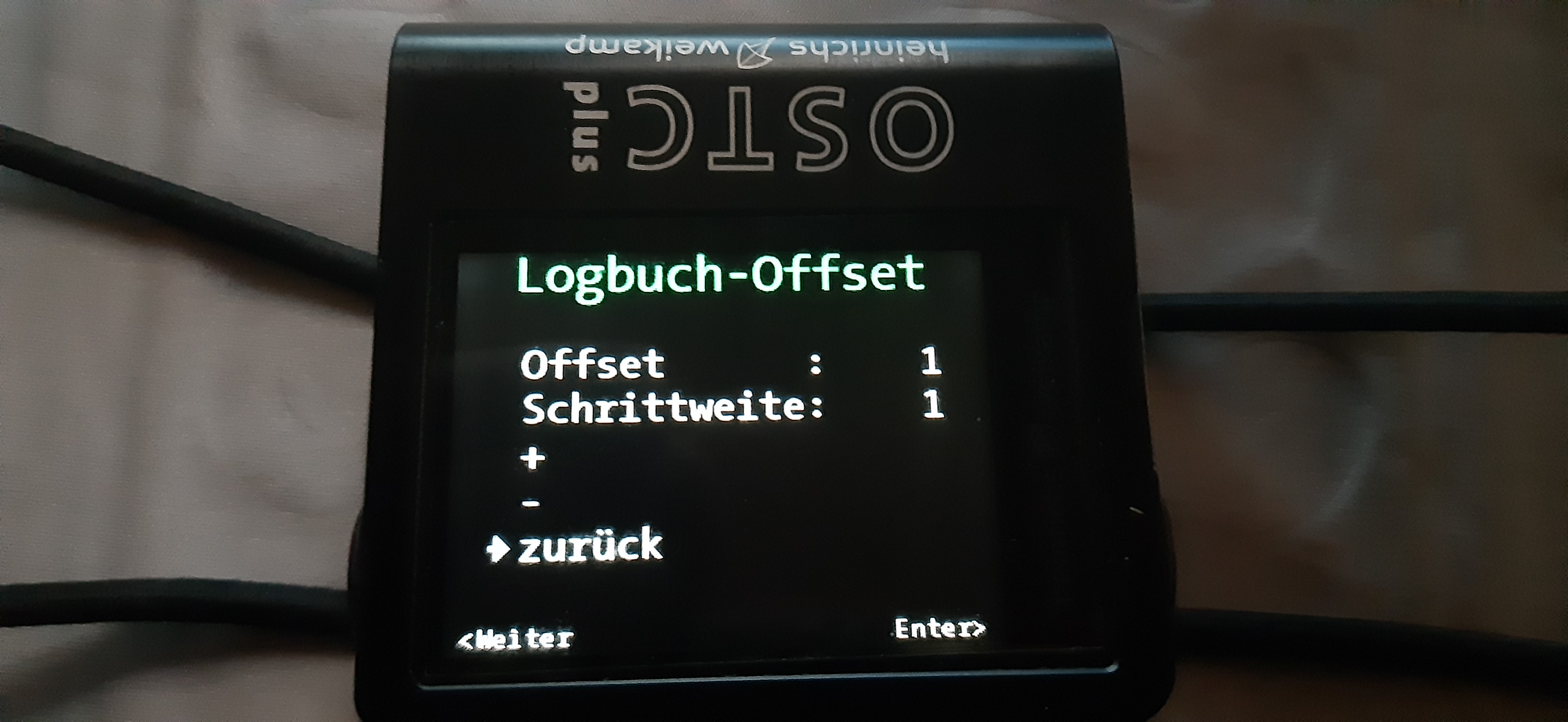

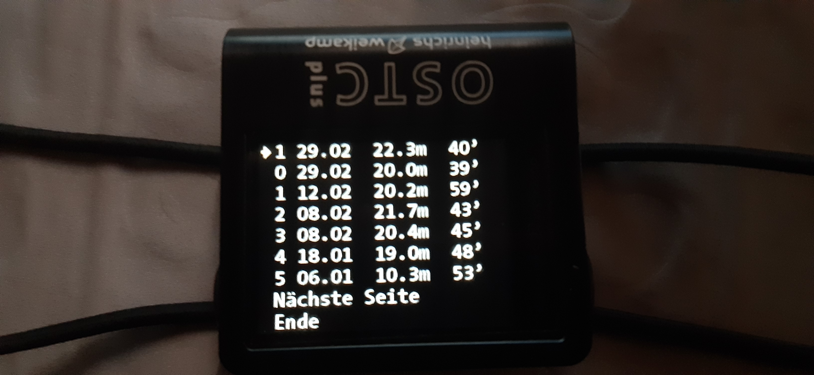

if the if the offset ist turned to 1
the log shows
which makes no sense at all
yeah - thats what i didheinrichsweikamp wrote: 26 Mar 2020, 14:19Yes. And that's the intent behaviour. Newest is #1. Just like in most of other dive computers.gr3yw0lf wrote: 26 Mar 2020, 14:16 nice - but it counts downwards from the newewst to the oldest - means, that the last dive will allways #1
This only works, obviously, when you have more real dives then dives in the OSTC's logbook....

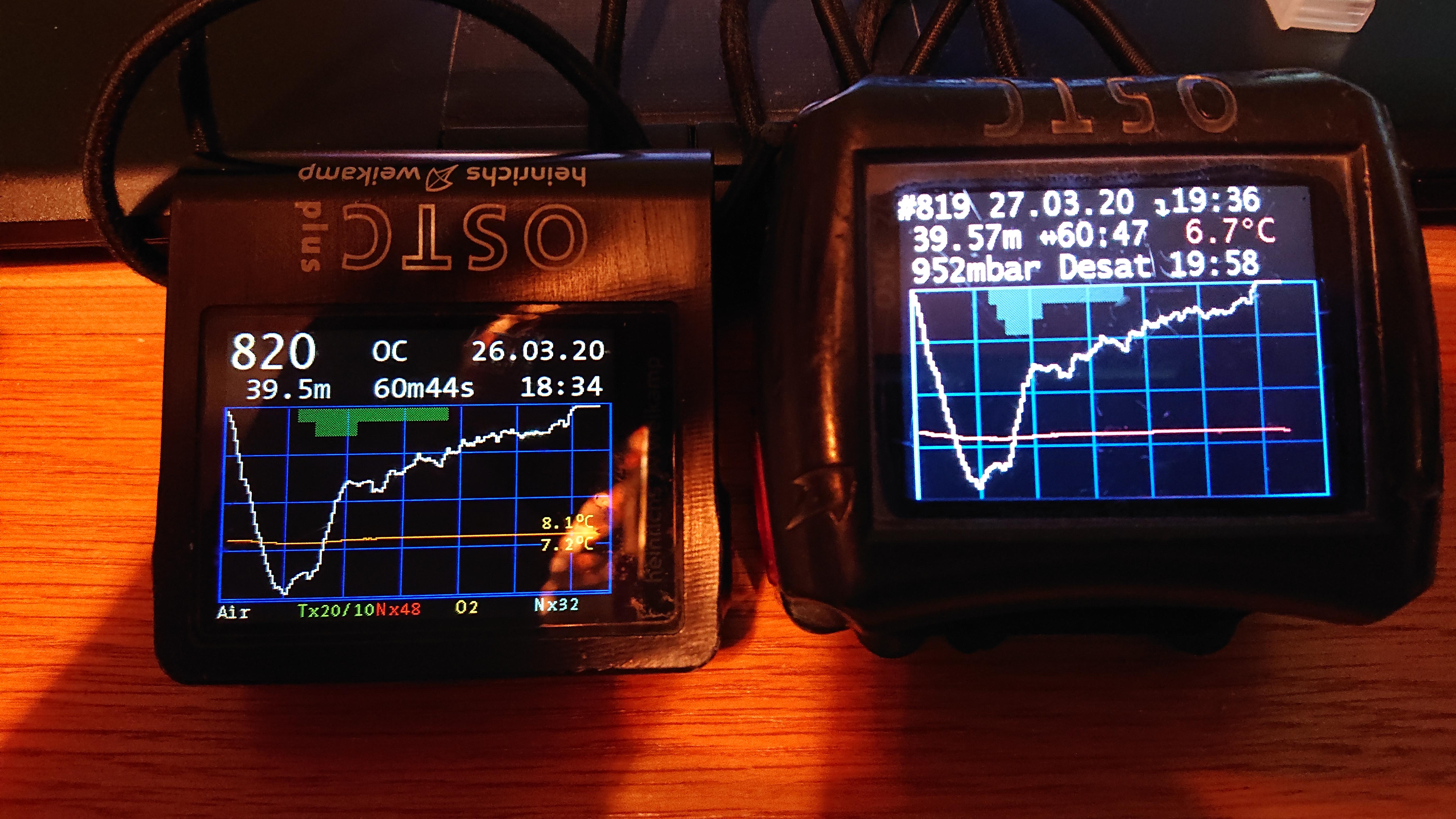

Hi all
I was diving today with my OSTCplus on V3.09 beta 4 and my OSTC 2C on V3.13. The new firmware works good during the diving and also the download via bluetooth to Diving Log works without problems. Many thanks to the whole HeinrichsWeikamp team.
The only thing I was wondering a little bit was the deco. On the plus the first stop was on 6 m and on the 2C on 9 m (see enclosed picture). I use on both computers the same GF 30/85. Is the 2C more conservative then the plus?
Michi
OSTC 2C #7452
OSTCplus #17296
Michi
OSTC 2C #7452
OSTCplus #17296
Hi Michi & all,
well, let's say both computers compute a little bit differently: on the plus the deco obligation kicked in a little bit earlier than on the 2C, and it persisted a little bit longer. Therefore it computed allowance to ascent to 3 / 6 meters, whereas the 2C computed that at least one (and perhaps only one) tissue required a stop at 9 meters during part time. As stops are rounded to multiples of 3 meters, the 9 m stop may have had a deco obligation of only 6.5 meters behind or any other number between 6.01 and 9.0.
One tip: in hwos, there is a custom view that shows the supersaturation of the leading tissue and the resulting deco ceiling judged with GF high figured in. These are the relevant numbers before the GF low/high interpolation and the 3m stop interval rounding get's applied.
The Bühlmann model is not defined by a given formular on how to calculate a deco schedule, but just two basic equations on tissue on/offgassing and max tissue oversaturation - how to actually compute a deco plan from this is left to the designer of the dive computer software. And the softwares of the 2C and the plus (current hows firmware), although sharing a common approach in how to calculate the deco, do it a little bit differently, without the one being "better" or "more right" than the other. What i can say after now about 2 years of working on the current hwos code is, that it sticks as close as possible to the raw and unmodified (unpadded) ideas of the Bühlmann model. But deco will always remain a science of probabilities, not guaranteed numbers. So please do not expect too much from any dive computer, but understand the model and the factors that also influence the body's deco needs that can't be sensed by the computer, and make your own stop decisions...

don't know, if thats related to beta firmware...
Due to lack of real diving in corona times i played a little bit with the simulator: Are there some limitations in regard of button time or TTS? (in the simulator as well as in real diving mode)
Backgorund: i wanted to see how the saturation bar and the leading tissues behave/change. Two times (Air dives, 39m) the simulator suddenly changes depth to 0m (i repeated this in order to be sure that i don't pressed "quit" in the simulator). In both occasion the button time was slightly over 100 minutes and the TTS over 200 minutes...
ps. the simulator is a magic piece of software! Not as good as real diving, but close
Hi Alex,
Thanks for your feedback. The simulator (Which is indeed a very powerful piece of software) quits after 90mins divetime to prevent battery drain.
