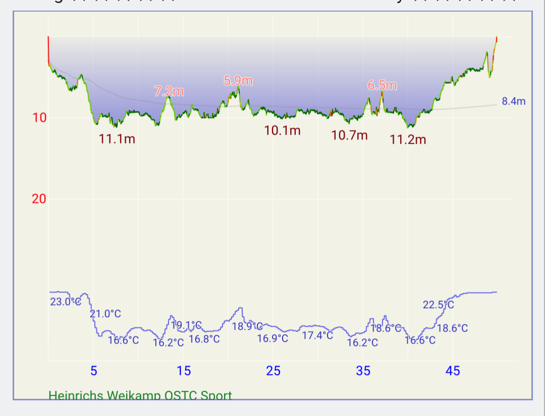

Hi. I did a long shallow non deco dive and the computer gave me a 3m/3min stop.
I thought that the last deco stop fires only on deco dives, and that th safety stop is at 5m.
I've attached the dive profile.
Can someone provide an explanation?

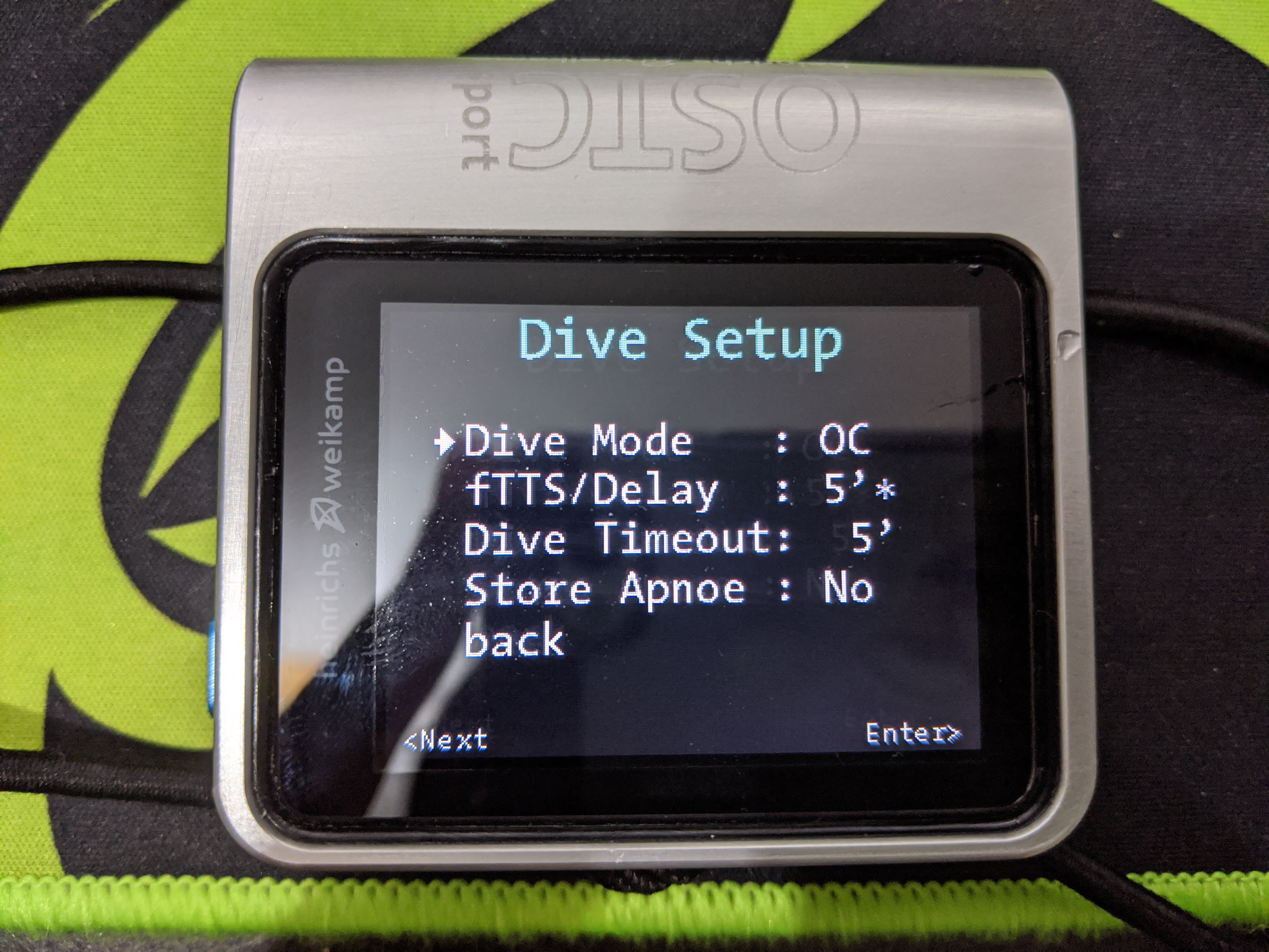

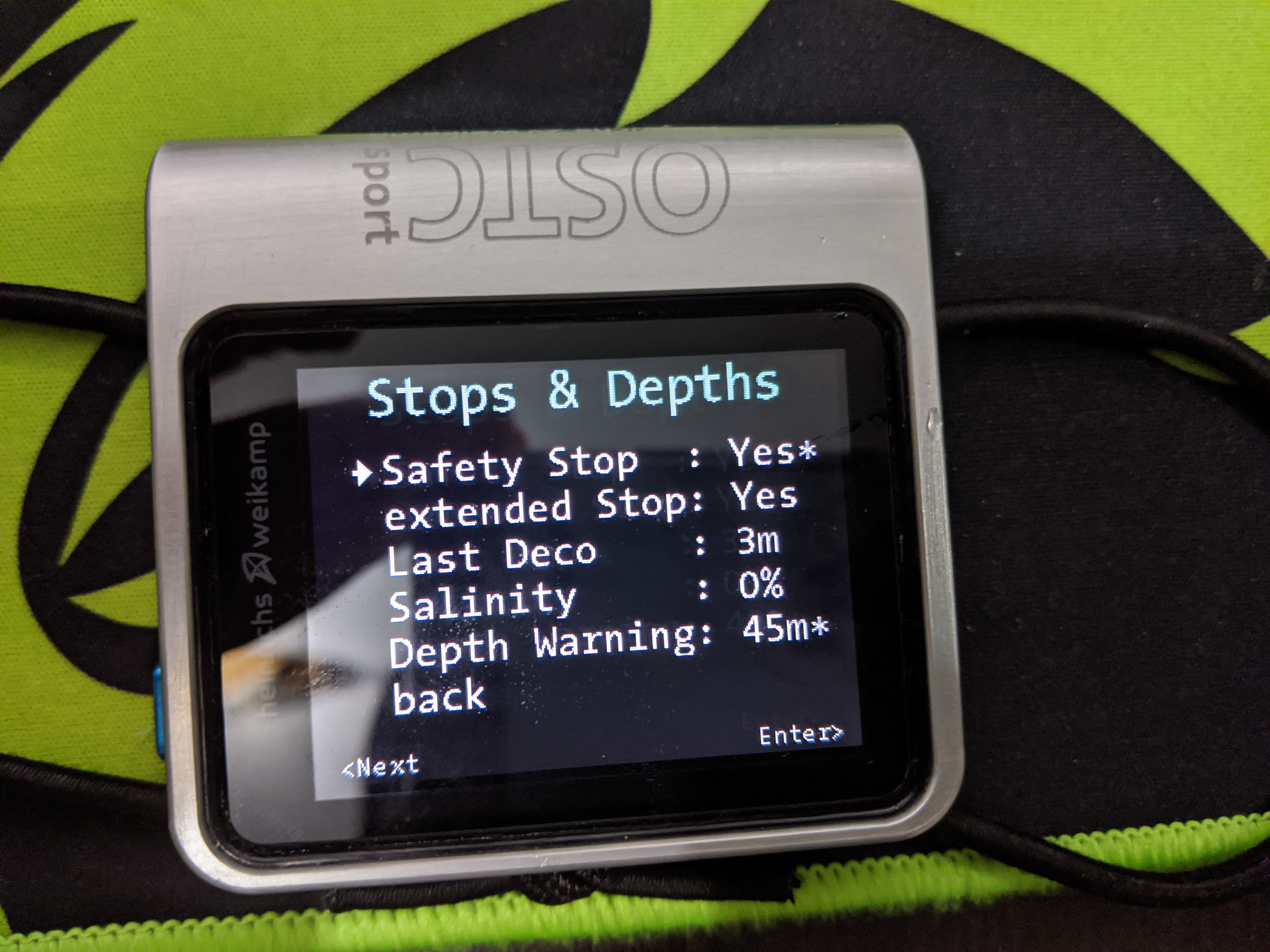

Everything was set to default. I just updated the setting to include a deco stop.
I'll post images of my settings in a minute
Edit: I've attached the settings

So around 5.5m I got a notification for Stop and 2:59 displayed. And it didn't start counting down until I've moved above 4m.
