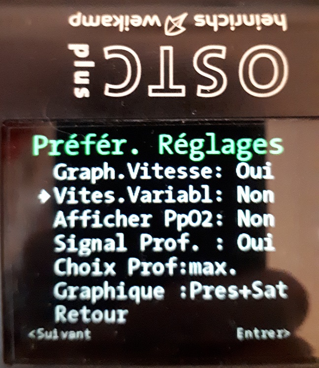

Hi ralph,
Main menu->Settings, (then after Simulator)->Display settings->in following screen, second parameter between Speed graph and Display PpO2: Variable speed (default=no):
Here is my OSTC screen display (in french):
French "Préfér. Réglages" = Display Settings
French "Graph.Vitesse" = Speed Graph
French "Vites.Variabl" = Variable Speed
French "Afficher PpO2" = Display PpO2
Yves
Re: Gradient Factors
Posted: 02 Oct 2020, 16:09
by Ralph
Ah, that's DISPLAY settings, having nothing to do with DECO settings! This is the "Speed .. adaptive" setting i wrote about: if switched on, the color coding of the vertical speed bargraph depends on current depth, becoming more erarly red the shallower you are.
10m/min is - at least as of Bühlmann - not >recommended<, but the >maximum< ascent speed the model is valid for. Doing it slower, especially on final ascent to surface, is strongly recommended. Remember: the highest tissue supersaturation and the highest relative pressure change occure on reaching the surface!
As of the depth displays: sorry, i didn't get the point: Current depth is rated the most important display and hence always visible. The ascent/descent speed is only shown when a vertical motion is sensed, and the additional vertical speed bargraph comes only on display when in normal layout and the direction is ascent. Was that your question?
