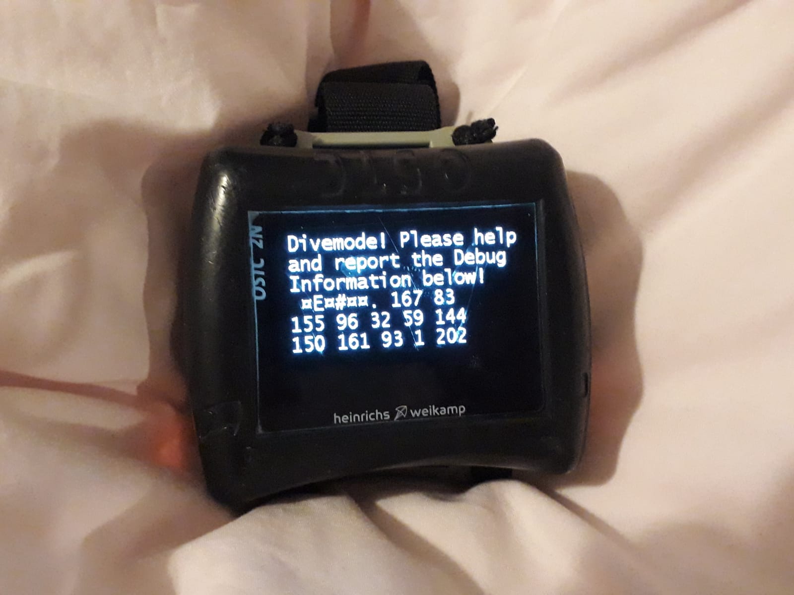

Here attached, a debug message appeared this week-end on my OSTC 2N.
The computer didn't switch on (nothing on screen) during the last dive.
During the previous dive, I noticed some safety stop timer lags. When my buddy did end is own 3 min stop, mine was still indicating more than 1 min left. I never been out the safety stop depth range.
Posts: 4531
Re: DEBUG
The information makes not much sense in this case and are the result of a cold start (power cycle). It may indicate that the battery needs to be replaced in this 2N. But I would recharge the unit first and check this post here, too: viewtopic.php?f=2&t=16518
