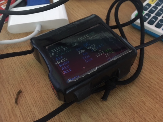

My OSTC is refusing to recharge correctly. Here's the device settings plus scenario:
Firmware 3.15
Battery set to T4
Battery voltage 3.6v
1. Battery 39%
2. Place on charging pad.
3. Green light blinks rapidly initially, then blinks slowly. Battery level indicator highlighted yellow - charging.
4. After a short time - maybe 2 mins - green light blinks rapidly. Battery level indicator normal - not charging.
5. After 30 mins rapid green blinking light has not changed.
6. Remove OSTC from charging pad.
7. Replace OSTC on charging pad and steps 3~5 repeat.
8. After several cycles battery level reaches 40%.
What is going wrong? What settings are incorrect?
Picture of computer attached - if it helps?
