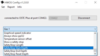

I have OSTC2 with tech fw and OSTC4. On OSTC4 I can change the safety stop depth and would like to do the same on OSTC2.

You can configure this with HWOS Config or Subsurface.
https://www.angermayr.eu/index.php/de/s ... ostc-tools
