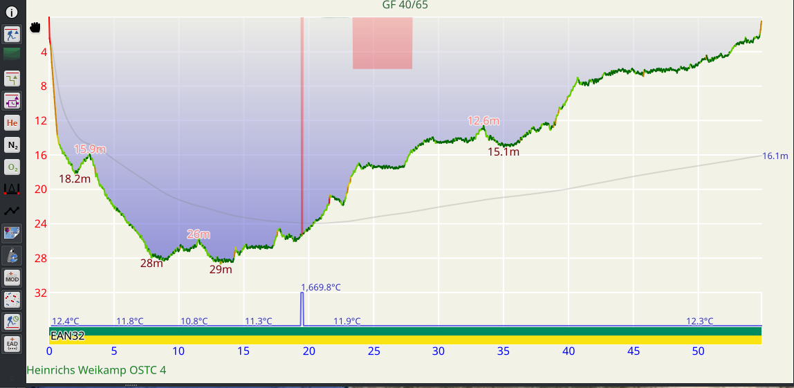

First dive with the new updated firmware.
Diving on cold water when at time 19 minutes It seems that I accidentally hit the temperature of the sun! 1669 °C plus had an instant Deco Ceiling to 26m (my current depth) on an otherwise almost No Decompression Dive.
@matthias or @heinrichsweikamp Contact me if you want to get the exported dive from Sub Surface in case you need it for analysis.
