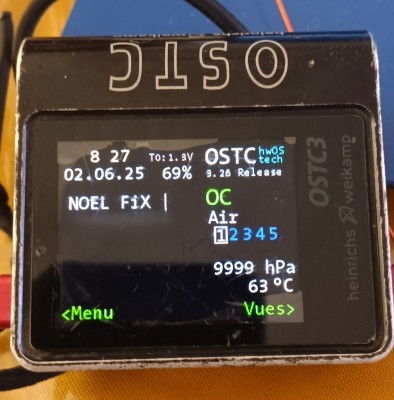

Hello, I'm having a problem with my OST 3. The pressure/temperature sensor no longer seems to be working and displays a pressure of 9999 hPa and a temperature of 63°C upon startup.
Is a repair possible?
Thank you.

Email HW. Most probably the pressure sensor is defect.
Posts: 4531
Re: pressure/temperature sensor ostc 3
If this is an Bluetooth OSTC 3 we still can repair these. Contact us: info@heinrichsweikamp.com

it's an old one no bluetooth
serial nb 2273

Due to unavailability of parts we can replace the pressure sensor in the old USB OSTC 3 anymore.
