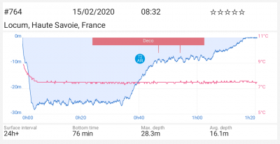

I have 1.5.2 RTE 2.02 installed and now during a decompression dive, using VPM, suddenly the decompression time and depth switches from say 5 min. at 3 meters down to 15 min. and 10 meters for a very short time and then goes back what seems to me normal. For this dive it happened twice.
You can see this in the attached profile (from DiveMate, though it shows up the same in the OSTC 4 log).
Perhaps this could be corrected?
Thanks very much
Christoph

Can you download this dive in subsurface and email us the XML file of it? I'll have a look into this then: mh@heinrichsweikamp.com

Ok, I will do that during this week, need to install subsurface before ;-)
Christoph
