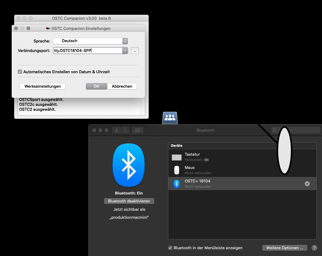

charles wrote: 08 May 2020, 12:42 Port : Port is not defined.
Erreur: Port : Port is not defined.
Check our FAQ: https://heinrichsweikamp.com/service/faq
OSTC Comanion says "Port not defined"
The communication port assigned by the operating system must be set. To do this, click on the gearwheel symbol next to the selection menu. Further settings can also be made there (e.g. the program language).
If there is no COM port selection available but you paired the unit in the System Bluetooth settings already, you can also manually enter the port here. On a MAC OS device, the ports are called "tty.OSTC12345-SPP" (Replace 12345 with the serial number of your OSTC).
Hope this helps,

bonjour et merci Matthias ton post m'a été très utile et m'a permis de mettre mon hosto a jour.
mais il a fallu que je prenne le MAC qui n'est pas sous CATALINA car en 64 bit le logiciel Companion ne veut pas fonctionné
encore merci
