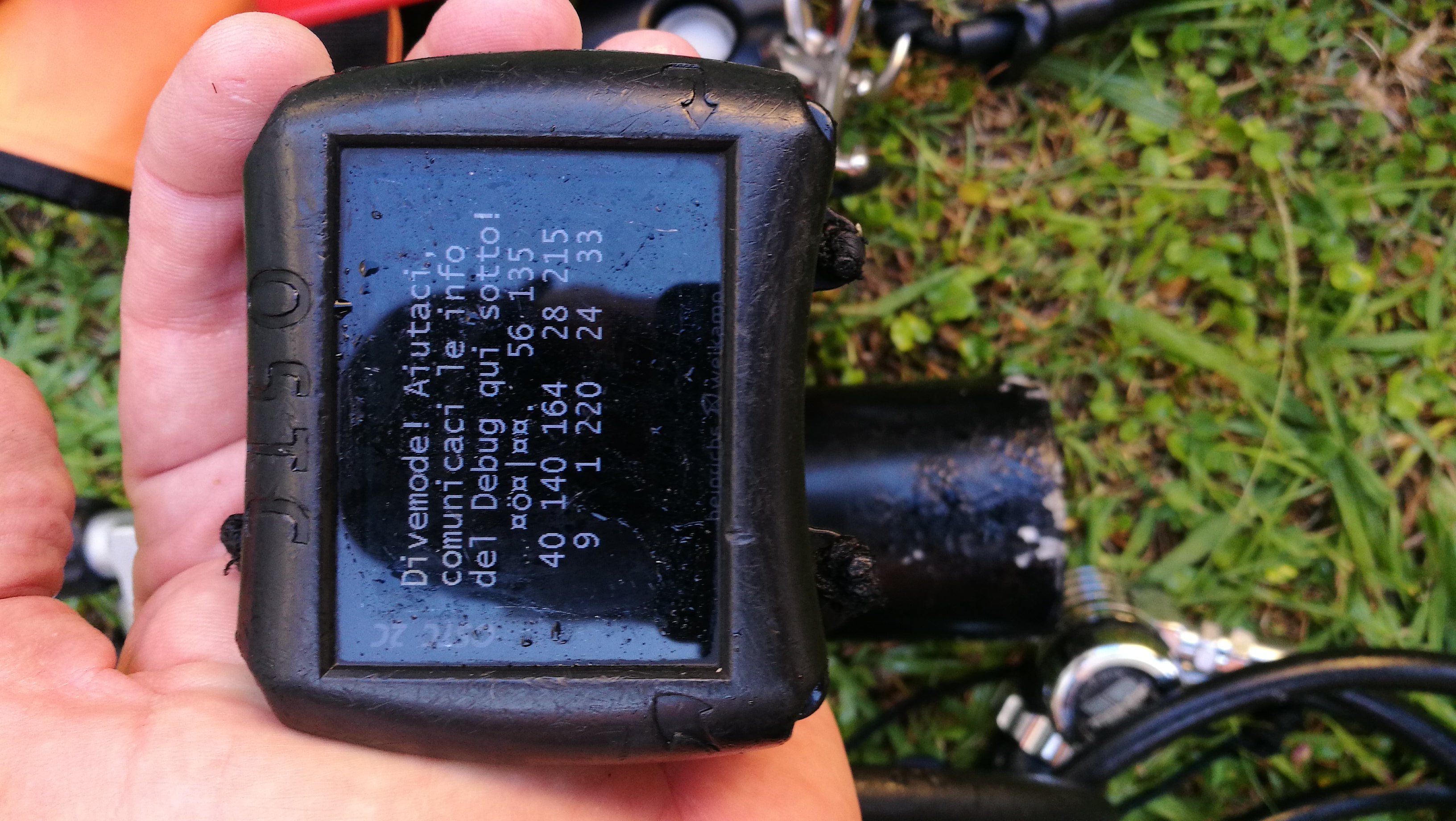

on display of mine OSTC 2N i see.
DIVEMODE! Aiutaci comunicaci info del Debug qui sotto!
56 135 40 140 164 28 215 9 1 220 24 33
[b]Who can I communicate it to?
how can i get out of this mode?[/b]
Posts: 4495
Re: DEBUG
This is a 2C, not 2N. But the error indicates a low battery.
Put the unit on the charger over night and it should be fine again. You can quit this error screen by pressing either of the buttons.

if the battery is damage, how can i change it?
Posts: 4495
Re: DEBUG
IF the battery is damaged, this can only be replaced at our place. But please read this post: viewtopic.php?f=2&t=16518 - we used (and use) very high quality batteries in the OSTC 2 so I doubt that the battery is dead even if the unit is between 5 and 8 years old now.

Thank you Matthias, but the official service? i don't found it on the heinrichsweikamp.com web site
Posts: 4495
Re: DEBUG
We replace batteries in the 2C for ~59EUR.
