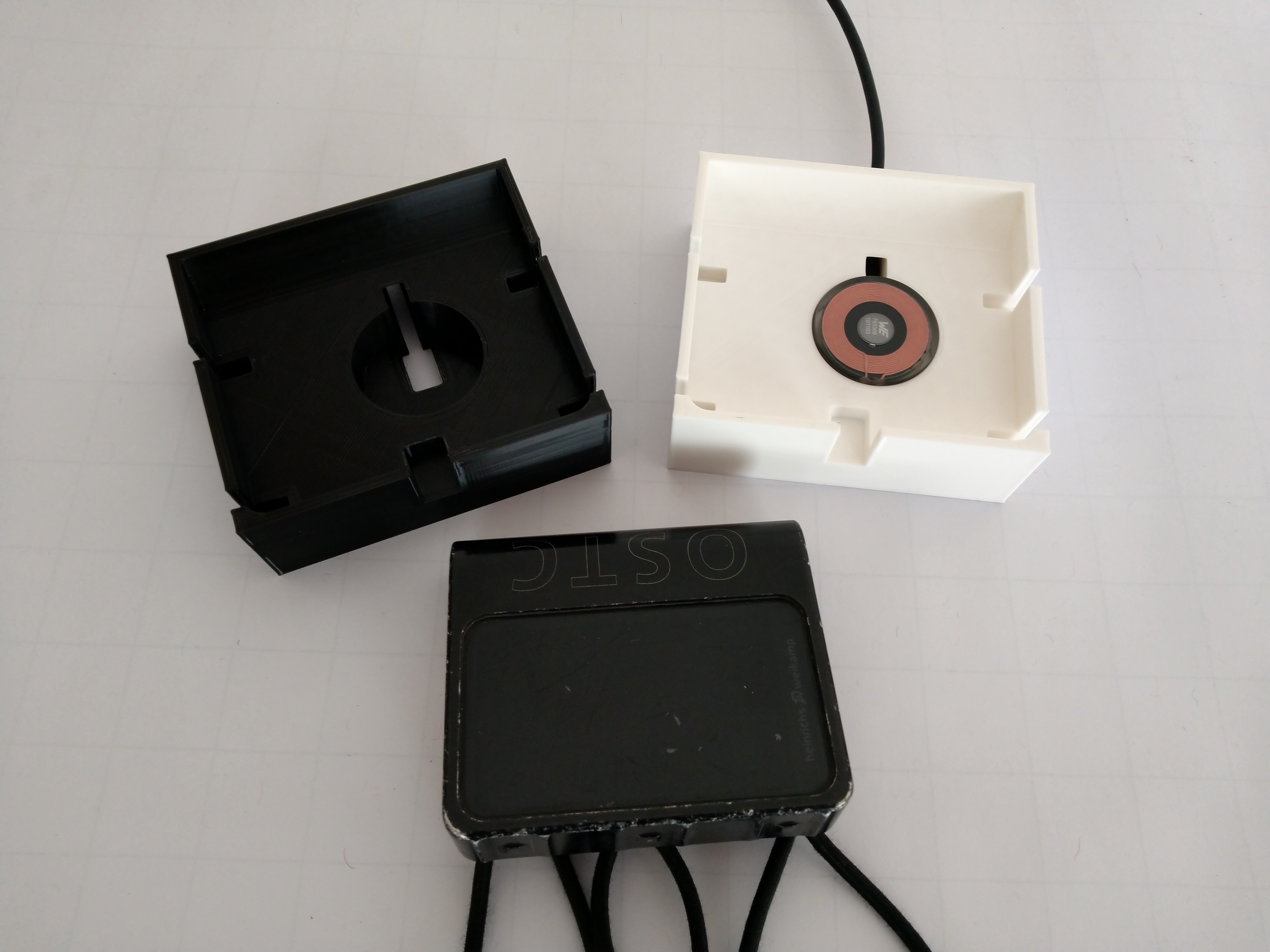

I think I've fixed my charging problem.
If anyone is interested in the charging adapter just contact me at sven.fruehwirth@gmx.de
Posts: 872
Re: Charging new ostc4.
Thanks Sven. I now just hold it with a bungee in place. That works perfect too.[img][attachment=0]20210715_062237.jpg[/attachment][/img]
