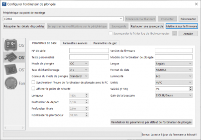

Comme pour les autres, OSTConf télécharge et installe la 10.70 français avec succès mais l'ordinateur redémarre sur la 10.68 (cela a d'ailleurs effacé le logbook!).

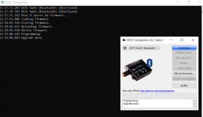

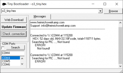

J'ai vérifié le port bluetooth (COM4), mais la mise à jour échoue avec Subsurface, OSTC Companion et avec Tiny Bootloader:

My OSTC Sport dating from October 2020 has a 10.68 firmware (English version). I followed the instructions concerning FW updates in other threads but none has worked. As with other people, OSTConf successfully downloads and installs the 10.70 release (French version) but the computer reboots on 10.68 (incidentally resetting the logbook!)
I have checked the bluetooth port (COM4), but the update subsequently failed with Subsurface, OSTC Companion et avec Tiny Bootloader:

Problem solved! Thank you so much Matthias!
It's just that my German is very rusty so I only read the English version of your tutorial which omits the reset instruction to access the "play symbol". I remembered that the "play symbol" appeared after each failed update with OSTConf, so I started another one and simply followed the next steps of your tutorial once it appeared.
Once the 10.70 release was installed (it was the English version), I used OSTConf to update to the French version of 10.70 and it has worked!
