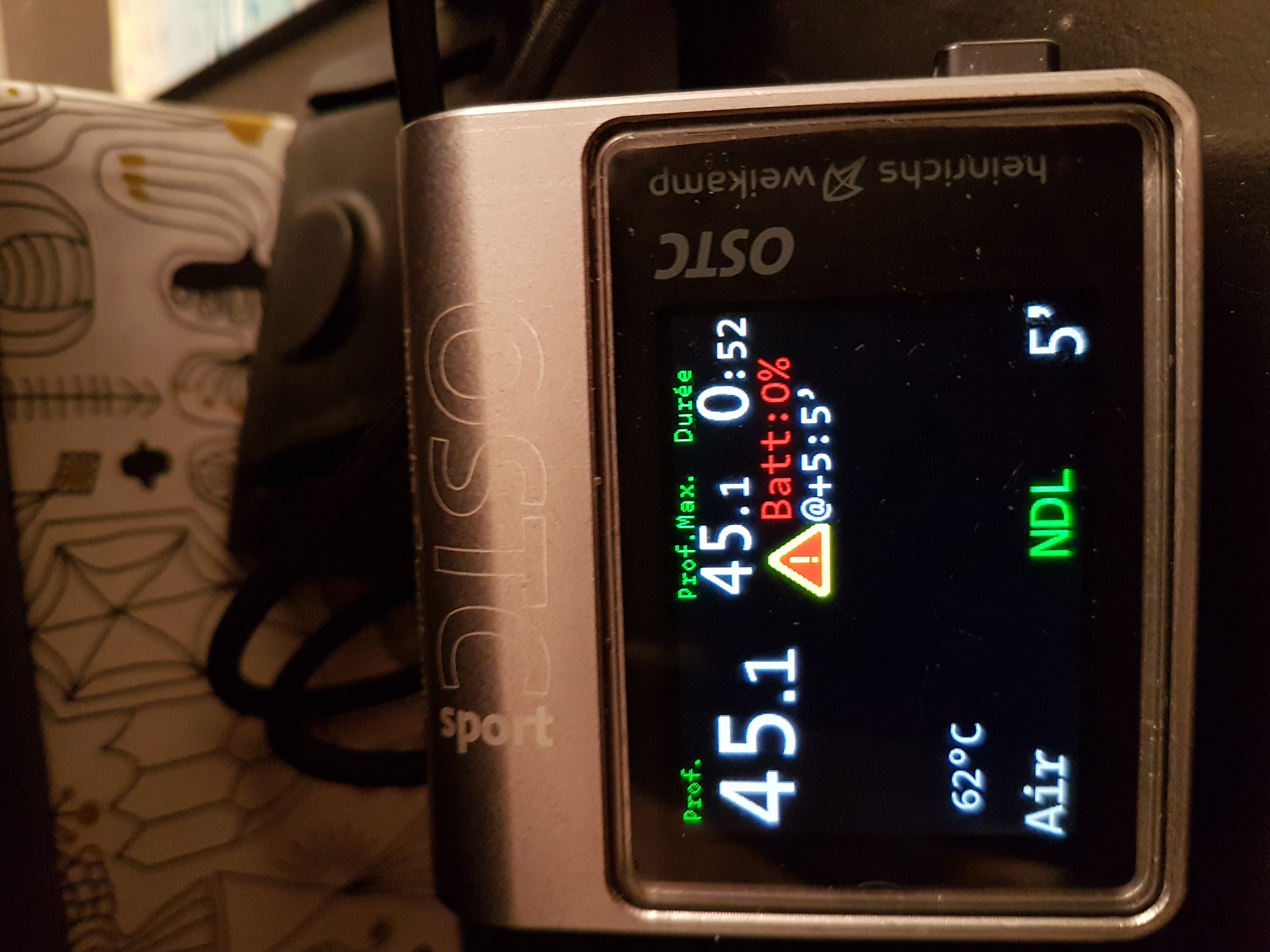

After replacing the battery, Saft LS14500 3,6V and after the reboot, my OSTC Sport has passed directly to a dive mode. The depht is stuck to 45.1m and the duration starts to raise. And the battery status is display 0% which is wrong since it's a new one (see attached picture).
It's impossible to switch back to the menu and I can't use my computer anymore as it is stuck to the diving menu. I couldn't exit from it.

62°C also look unrelaistic. The pressure sensor of the unit died and needs replacement at our place. Please email us in this case: info@heinrichsweikamp.com
