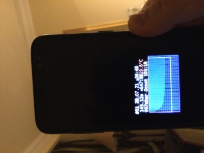

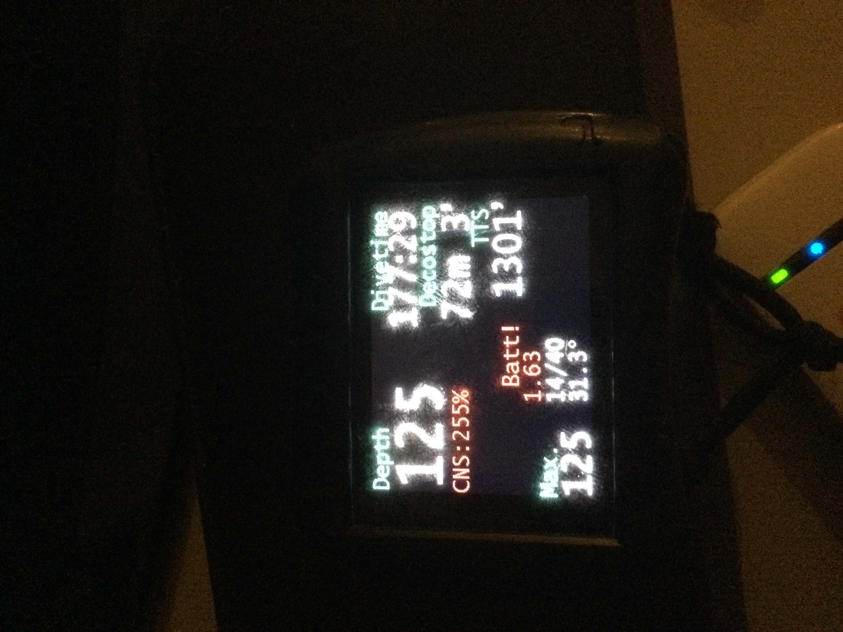

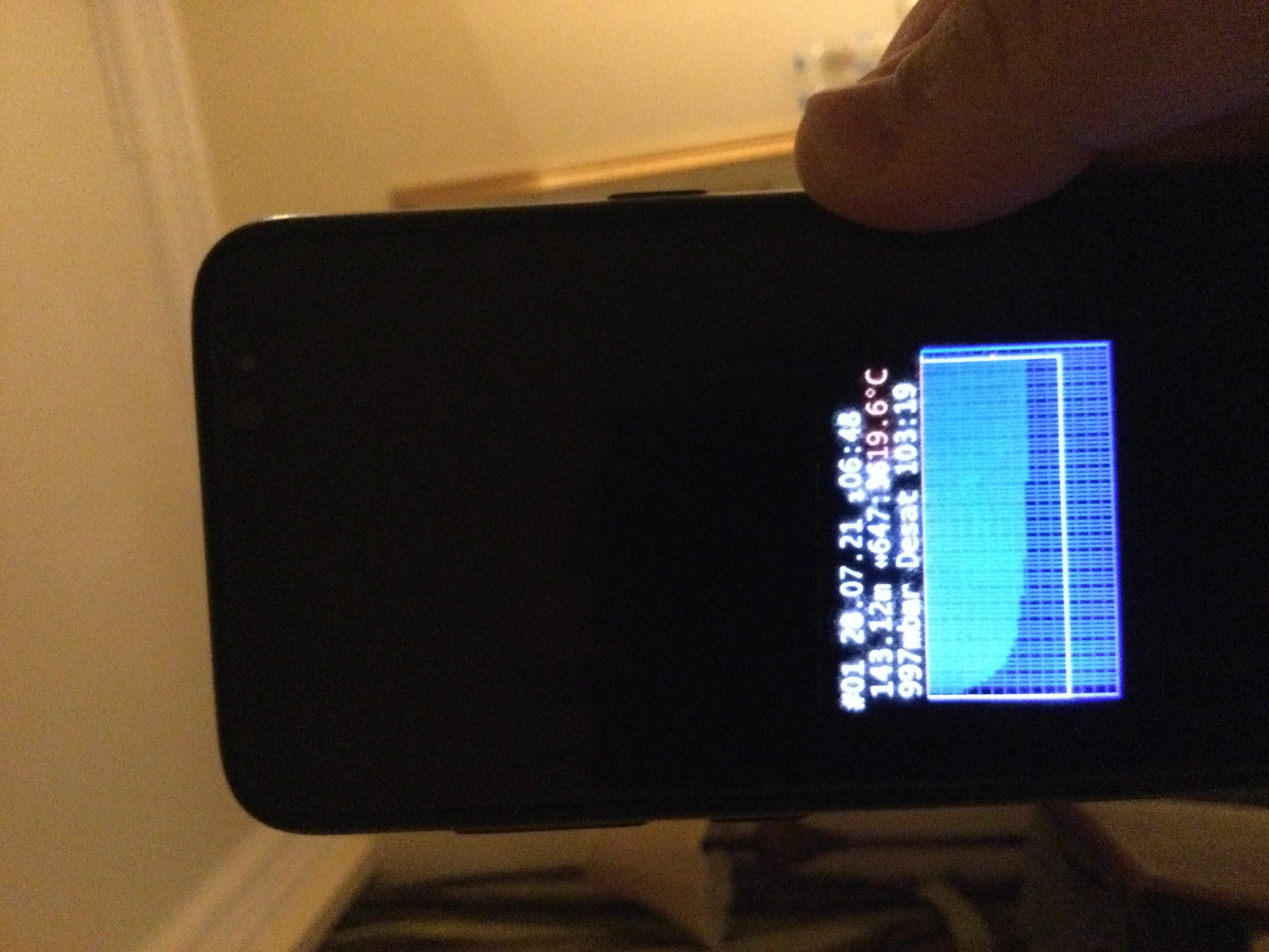

I tried to recharge it, but during the recharging it switches randomly to 125 or 145m dives, so completely stuck in dive mode. See screen attached.

Currently on bad wifi, but attached pictures froictures that i made with my phone earlier..

I could let the unit run out of battery for the third time, and now it goes into dive mode, screen works to some extent, but all dives end up as 150m dives, deco stays stuck at 240" and doesn't calculate properly.
Only used it as timing device with tables as backup since then.

- Posts: 4511
Re: OSTC 2 failing at 115m - screen bend in - stuck in dive loop after?
We still service these. And here, a new pressure sensor will do the trick.
Please contact us: info@heinrichsweikamp.com
