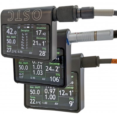

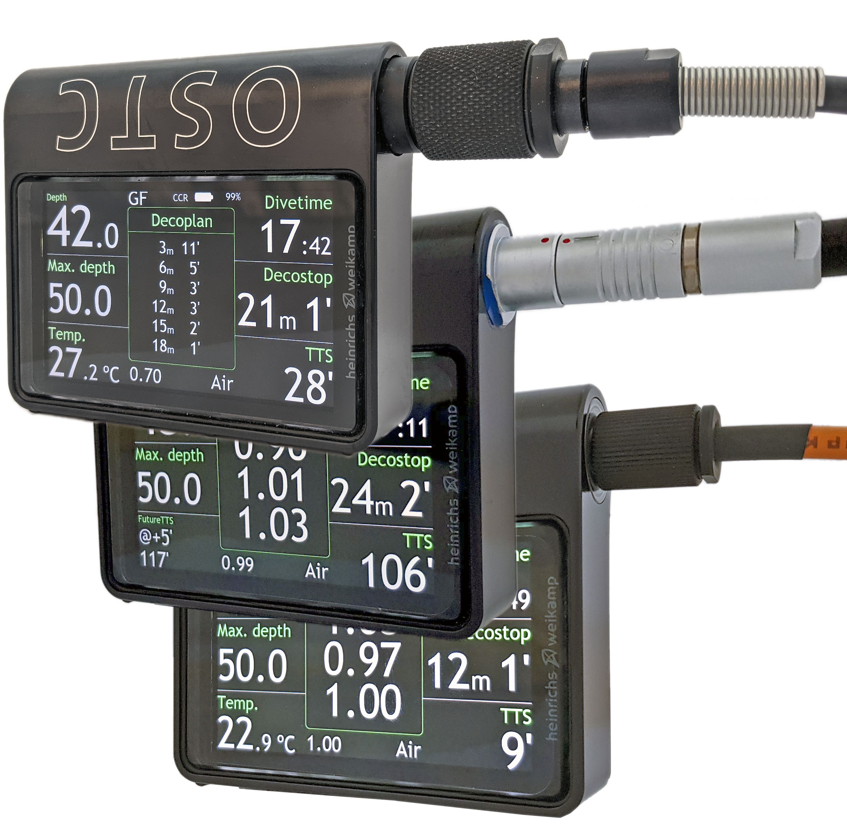

The OSTC 4 is available in three options:
Optical interface: Compatible with our ppO2 Monitor, can be plugged/removed during the dive
Fischer bulkhead: Makes sense if your rebreather already has a Fischer connector for secondary O2 monitoring
S8 bulkhead: Makes sense if you need to add a cable to your rebreather in any case. The S8 connector is mechanically and electrically much more robust then the Fischer connector.
Here's an image of the three version including the connectors.
This depends on the rebreather you might get. All modern eCCR have O2 monitoring and display/HUD included. Here, you really do not need to add the OSTC 4 with monitoring option. It's a different story for KISS, other mCCR or dedicated deco/oxygen rebreathers.
