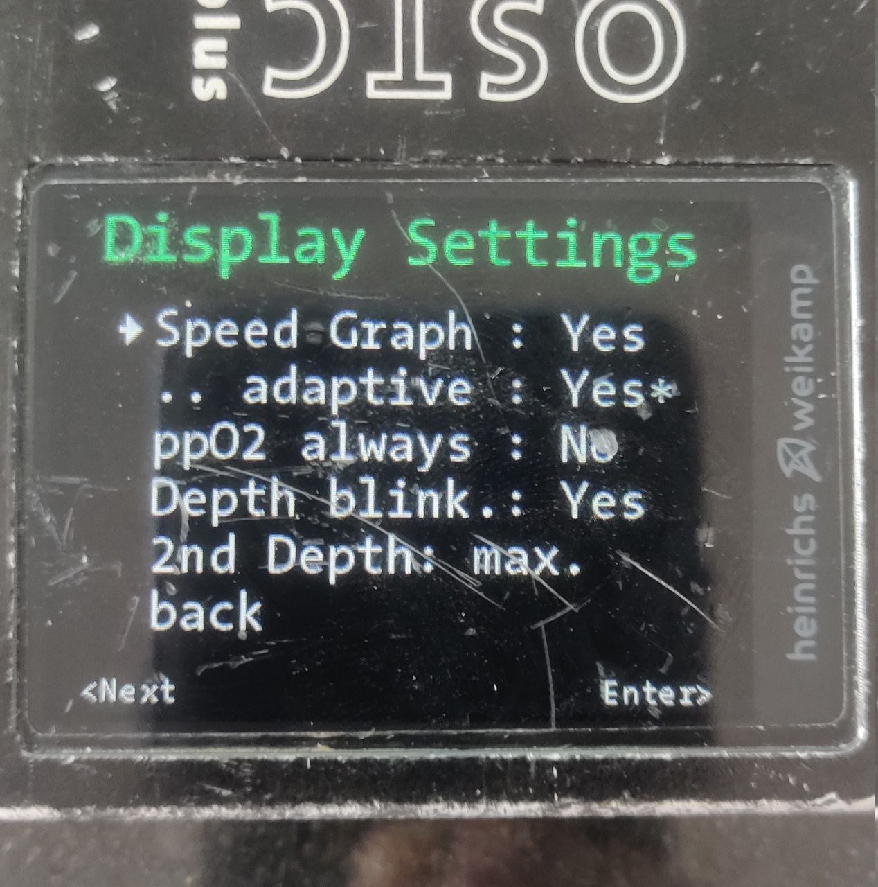

>> On my OSTC Plus I don't have Display settings menu to choose between N2+He, so I assume it is always "Pres + Sat"
>You should have: Main Menu -> Settings -> Display Settings -> more -> Graphics
Interestingly, I checked, and I don't have this option. See the pic attached.
[attachment=0]photo_2023-03-03_10-21-15.jpg[/attachment]
Posts: 754
Re: Tissue load question
Do you have the sport firmware? If yes, the setting may indeed been removed from the menu as with no He the N2+He view does not make any sense and there is no loss of information with only the press+sat view then.

kos
Posts: 11
Joined: 27 Sep 2017, 18:10
Post by kos »
Yes, the sports firmware.
