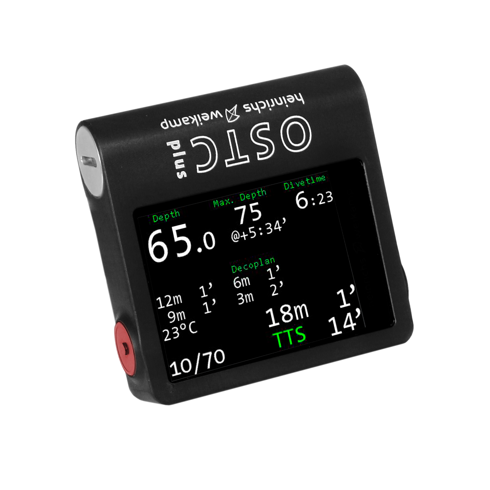

I've just ordered an OSTC+ from a local retailer, but noticed the product they show in their images looks like an older generation to the one shown on the main website. In particular, the text says PLUS instead of +, and the buttons look to be different (flush instead of inset).
Is there a summary available anywhere of what the differences are between the two units?

Older models: Current version (Since mid-2022): They use the same software and share the same screen, newer OSTC+ has some hardware changes and is also available with external O2-Sensor monitoring (S8- or Fischer-Bulkhead).

Great thank you.
They've confirmed it's the older model, but it was well priced and if they are functionally identical, I'm sure I'll still be very happy (wasn't expecting to use it with CCR anyway)!

You can bring the unit up to the latest software very easy with our mobile apps "HWOS Config" (Android) or "OSTConf" (iOS): viewtopic.php?f=6&t=14509
