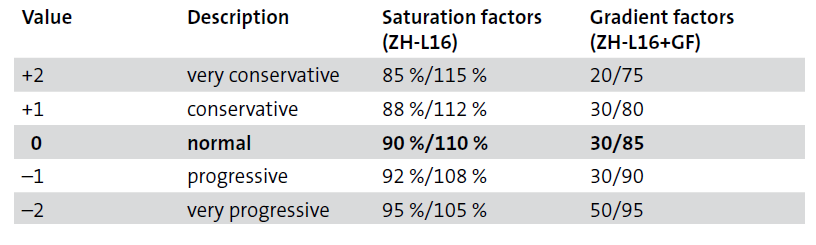

However, my original 10.4 firmware gave me a single conservatism setting whereas the new one has various options to adjust the GF and saturation.
I'm using ZH-L16+GF, is there any easy comparison between the old conservatism option and the GF settings?

- Posts: 4490
Re: OSTC Sport Dive Mode Switch-on
That's from the old manual (Page 17):
