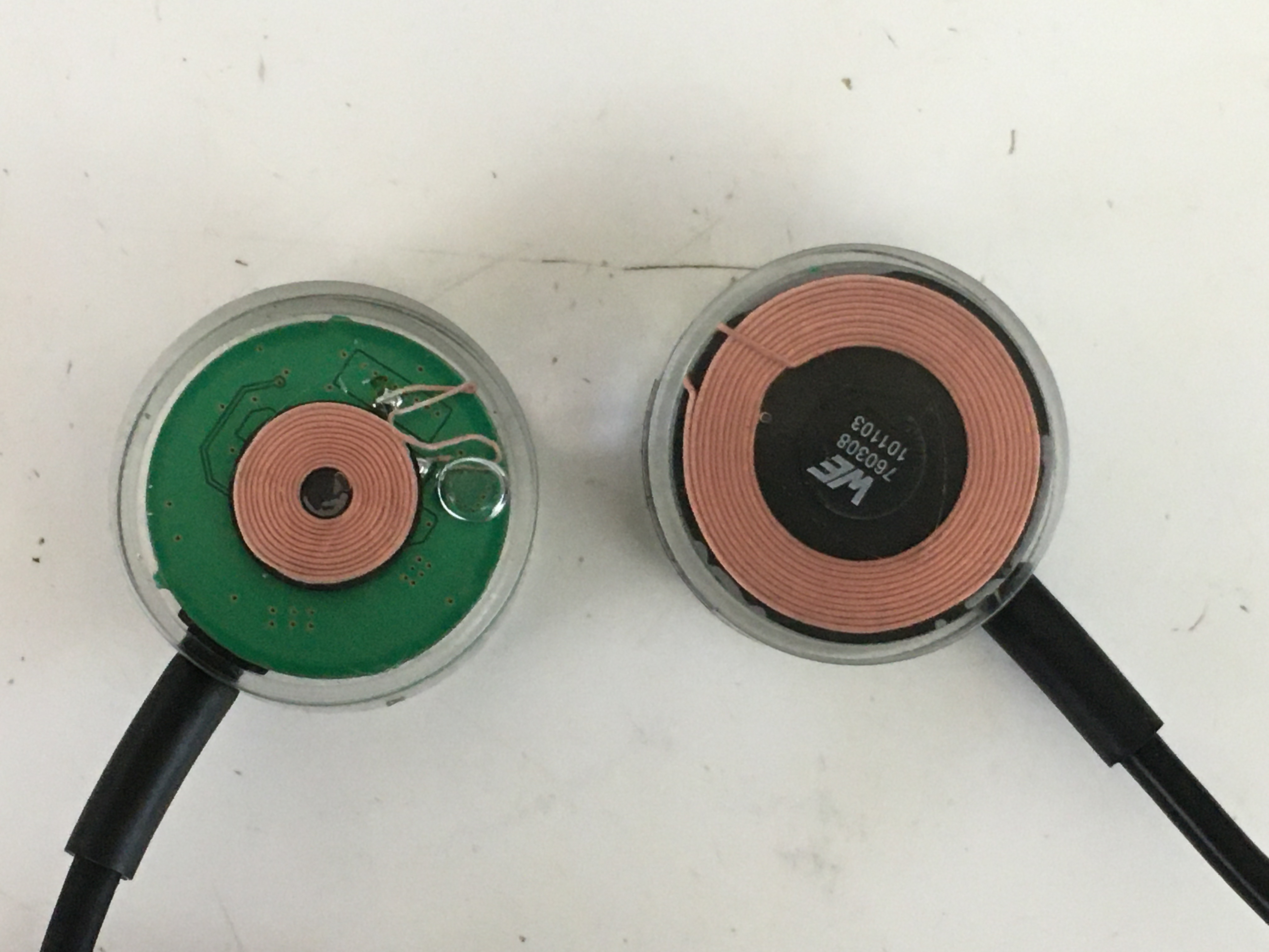

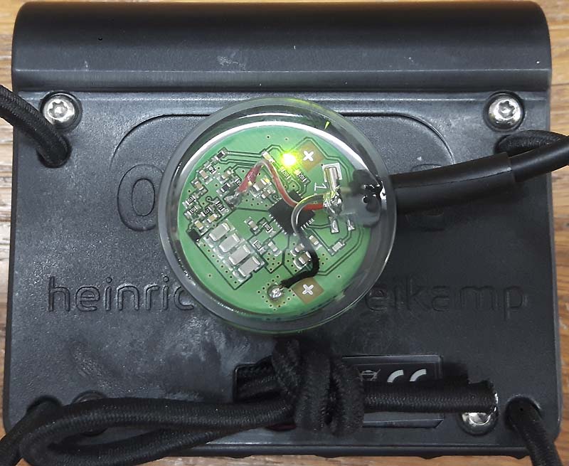

An empty OSTC4 takes about 5-6hours to recharge. This is checked with every OSTC4 we ship.
There are some things you can check:
- Power supply is capable of providing 2A at 5V?
- Newer OSTC 4 should have the charger with the small coil:
- Alignment: The charger must be placed as seen in this image:
It's unlikely that the battery is degraded already. We use high quality cells from reliable sources. These last many years, even when used daily.

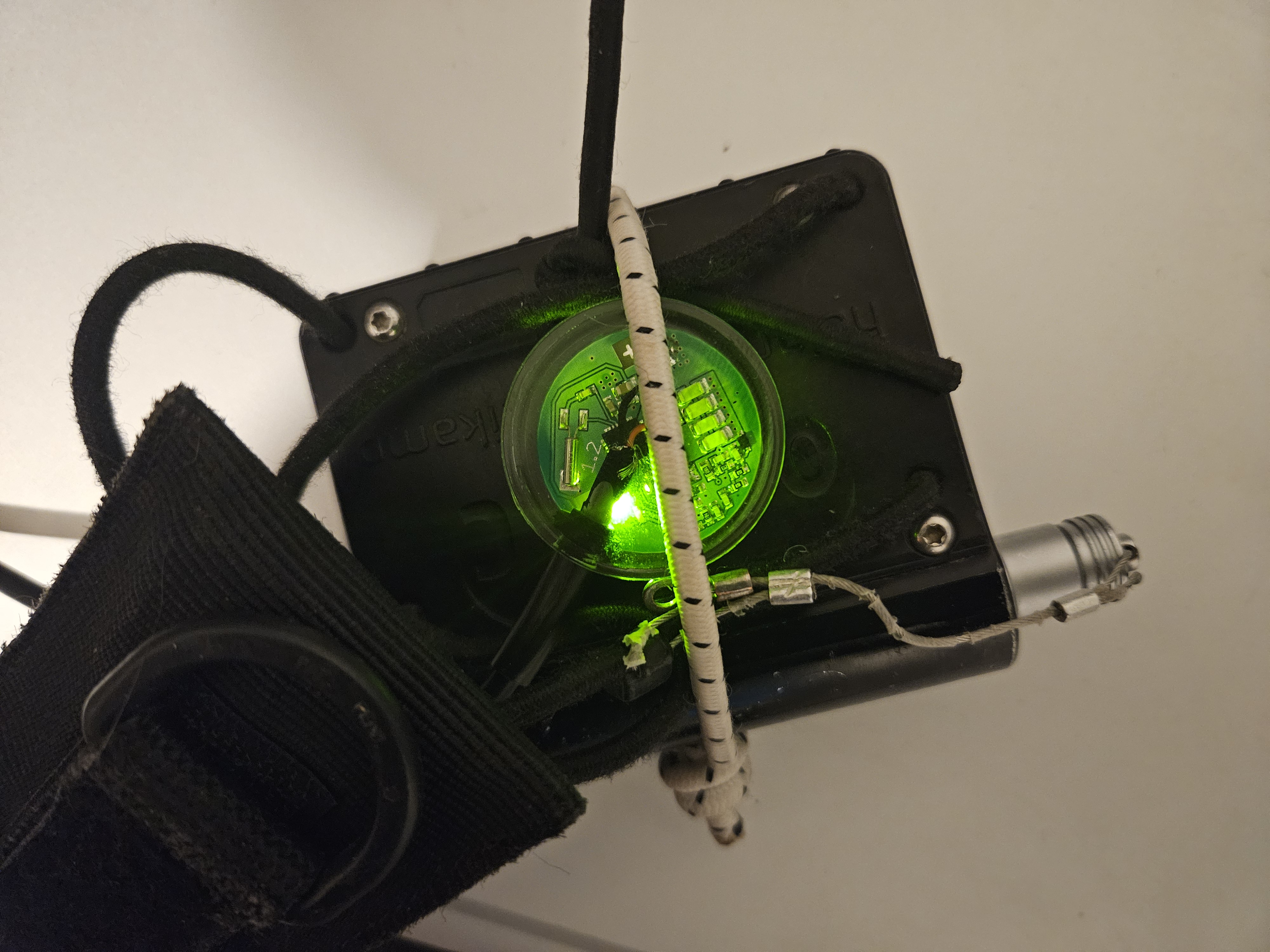

I do the charging like this:
[attachment=0]20231116_204653.jpg[/attachment]
Keeps the charger firmly in place.

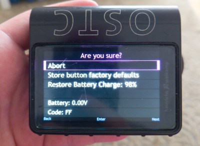

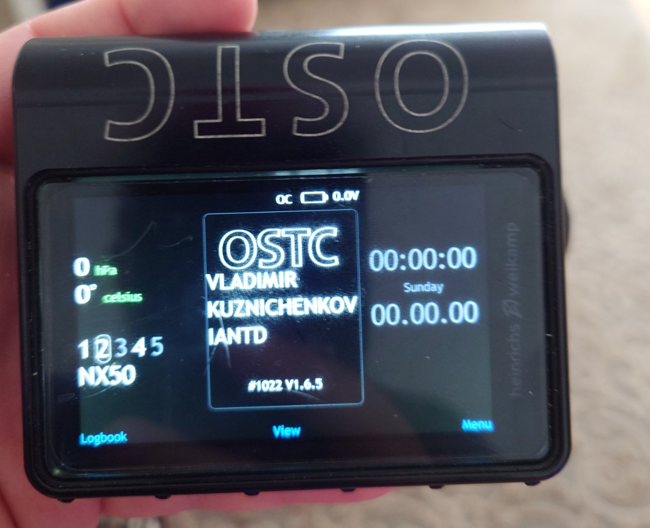

I update mine OSTC4 to 1.6.5 from 1.6.0. It was a bit discharged to 2.7V, I charged it to 3.3V on old firmware, then update it.
Now it show me 0.0V and in maintenance menu code FF. What does it mean?
Re: hwOS4: New Firmware 1.6.5 with RTE 3.20
Okay, it was my fault, I didn't flash RTE second time and it got a weird state. After flashing update one more time RTE got updated and now it is working correctly.
