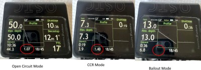

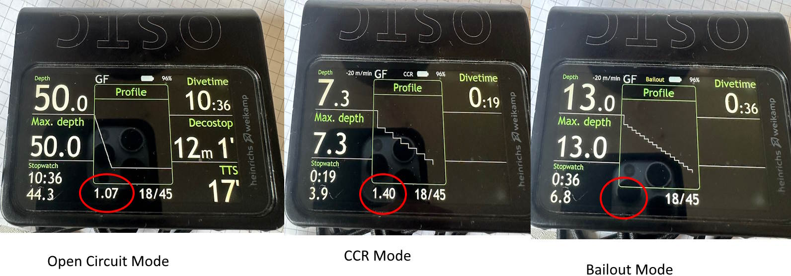

is it on purpose, that the permanent display of pO2 below the main middle window disappears in CCR mode when switching to bailout?

Yes, in bailout mode the OSTC 4 usues normal OC calculations for decompression and ppO2 warnings.

Hmm, but in normal OC mode, ppO2 is shown in the same way as in CCR mode. Only in bailout it does not appear - that does not really make sense. Thought ppO2 in bailout/OC is more important than copy the fixed SP on the screen, please find the screenshot.
