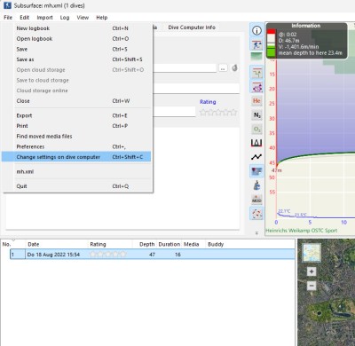

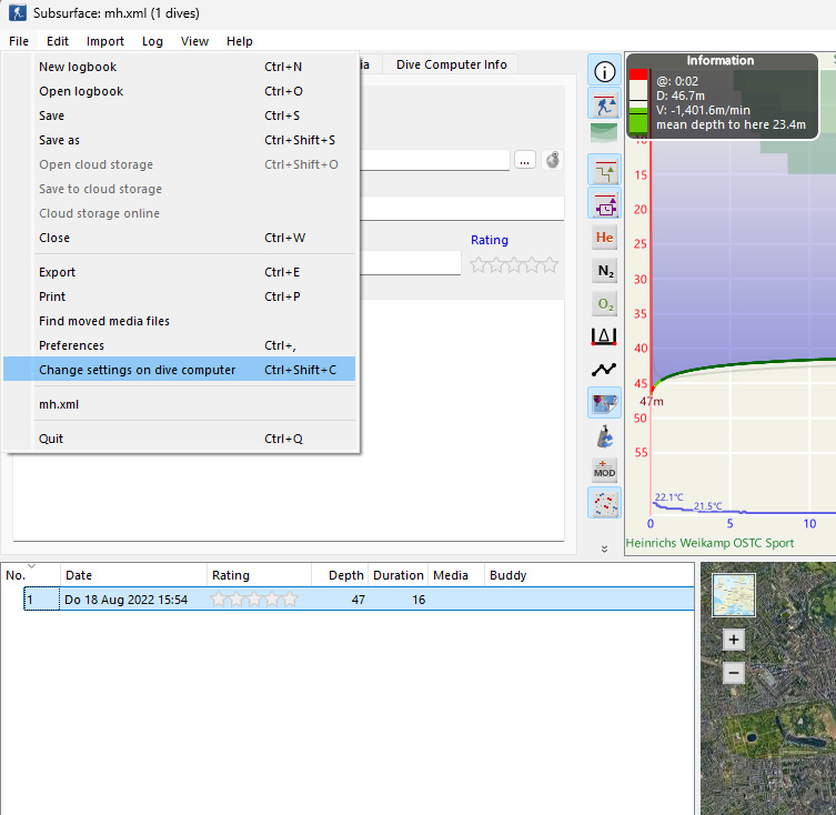

Step 1: Select "Change settings on dive computer" from the Menu

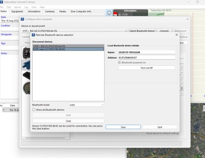

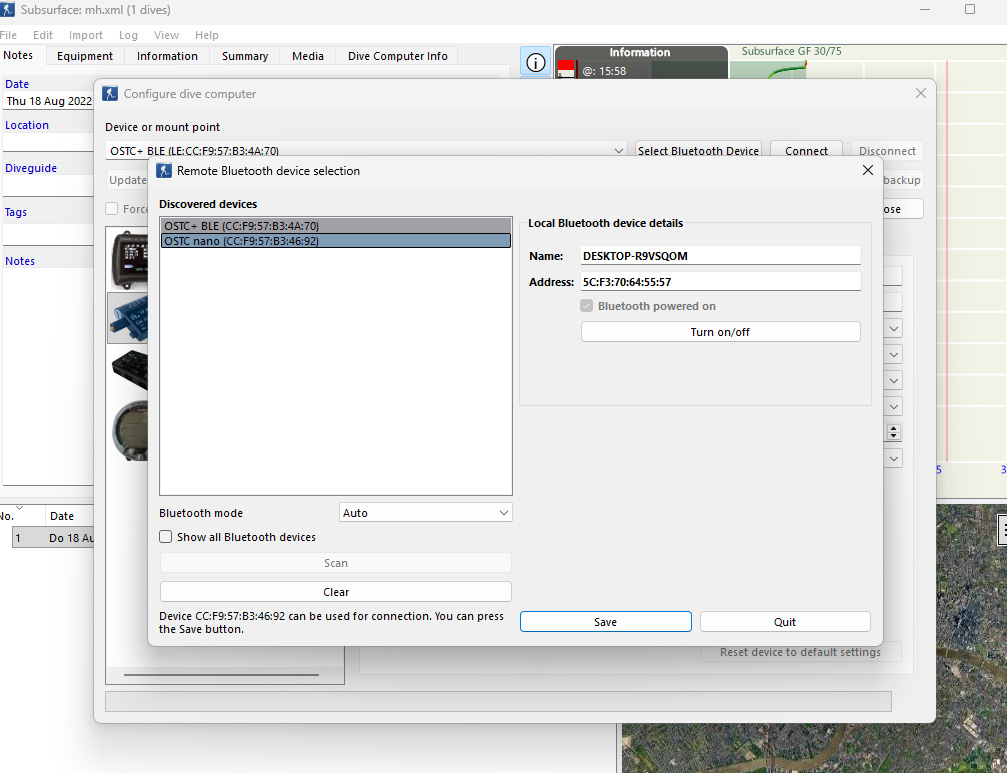

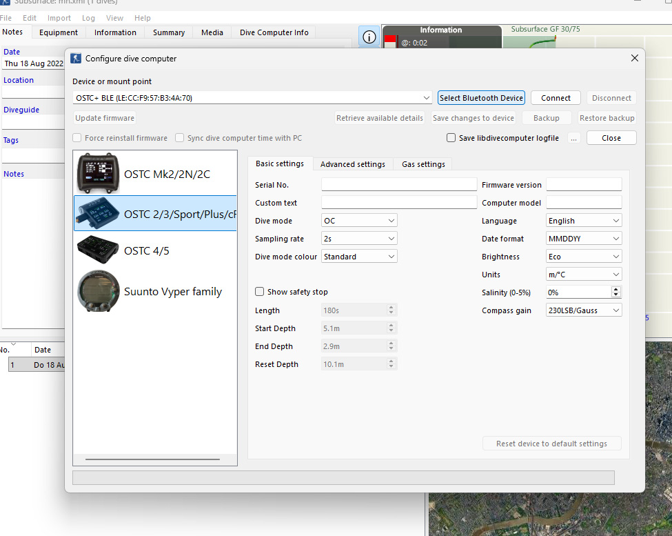

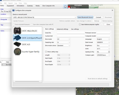

Step 2: Select OSTC 2/3Plus from the list and click on "Select Bluetooth Device"
Step 3: Click "Scan" and select the OSTC from the list. Click "Save"

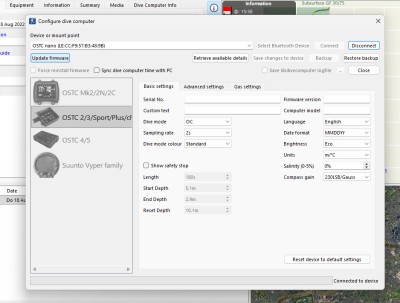

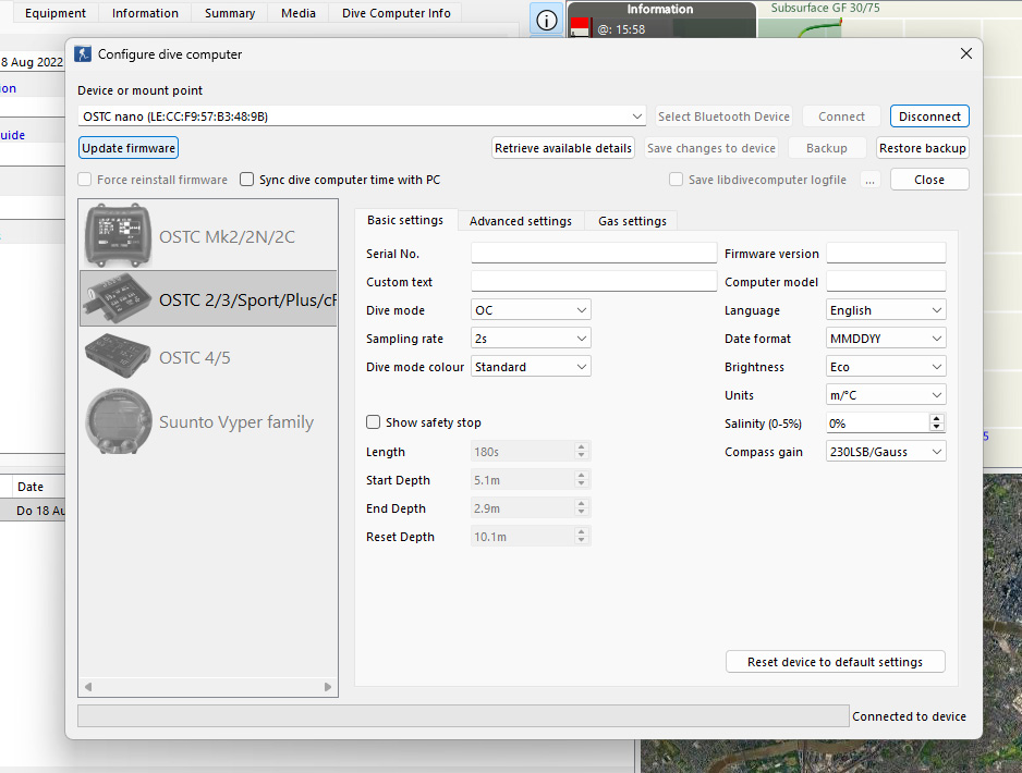

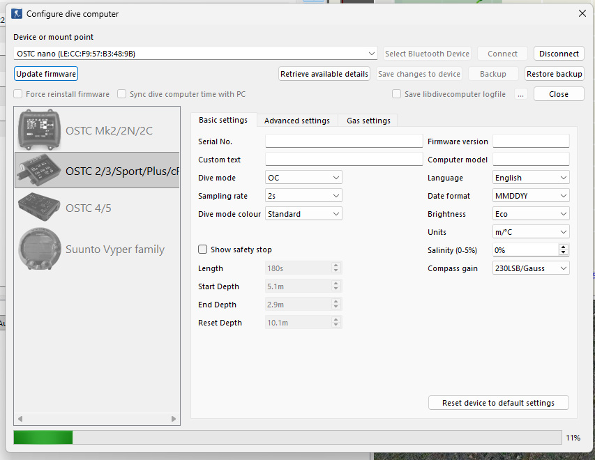

Step 4: Wait until "Connected to device" is shown at the bottom, click "Update Firmware". Select the update file (.HEX file) from your PC

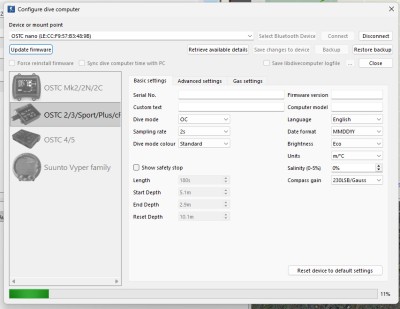

Step 5: Wait. The Update via BLE will take ~60 seconds. The OSTC will reboot into the new firmware automatically.
