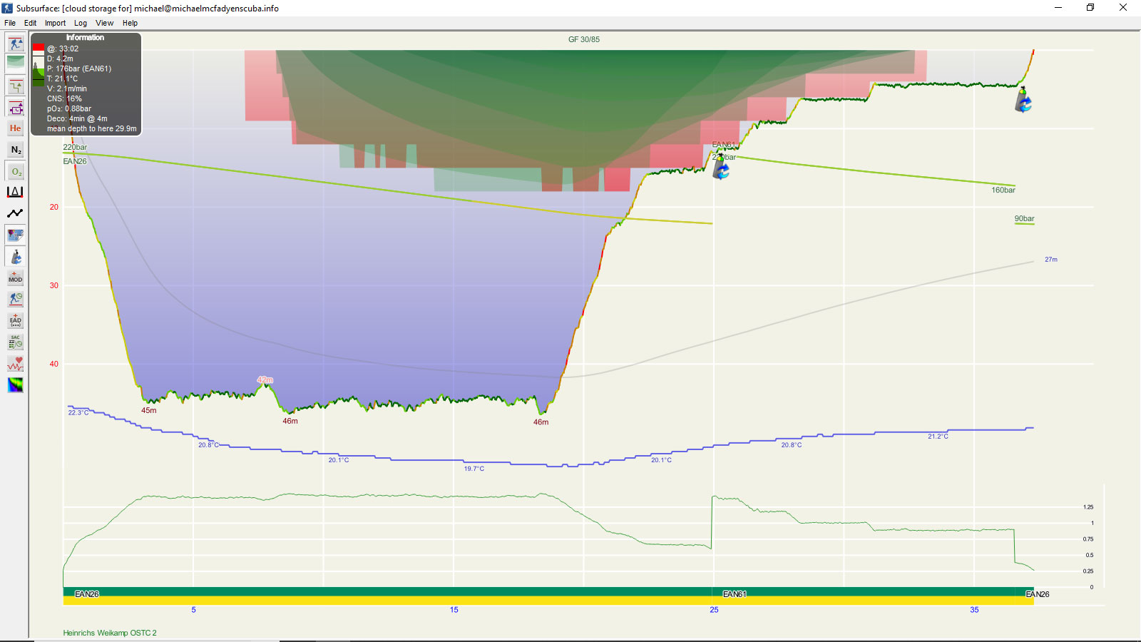

Today I did a 46 metre dive. The computer still does not take deco gases into account when showing TTS till you actually swap over. Also, the deco time for last stop went from 4 mins @ 4 m to cleared in one go. Why?
Michael

Re: hwOS Tech: 3.03 beta 1 released
Hi Michael,
did you activate the extended stops? Also read from the release notes:
- Added an option "extended stops" (named "Gas Change/...before 1.Stop" in Deco Setup -> Deco Parameters -> more). If set to YES, a gas switch will be planned immediately on the change depth of the gas, even if a stop on that depth is not required by deco constraints. When set to NO, the gas switch will be planned to be done on the next regular deco stop.
With extended stops enabled and a setting of "Gas Change (time):+0'" the switch will be planned with no actual halt at the change depth (i.e. "switch on the fly", "stop" time will be shown as ".."). With change time set to > 0', a dedicated stop will be placed at the change depth for the given number of minutes. This gas change stop may not be needed by deco constraints, but it will influence the following deco stop depths and times as it introduces some added time at depth.
For the other part fo the questions, well, some tiny bunch of information on settings and profile would help in answering.
See profile below. Note that at end of deco showing 4 mins @ 4 metres and then nothing.
Settings
Bottom mix: NX26
Deco mix: NX 61 with change set for 13 m
GF: 30/85
Sat/desat: 100%
Last deco: 4 m
Gas change: +1
before1.stop: +1
Note that first deco stop was 1 @ 9, not 1 @ 4 like it used to be. As I had set gas change to be 13 m, I could understand if it was 13 m, but 9m?
Hope this helps.
http://www.michaelmcfadyenscuba.info/images3/tuggerah-profile.jpg
