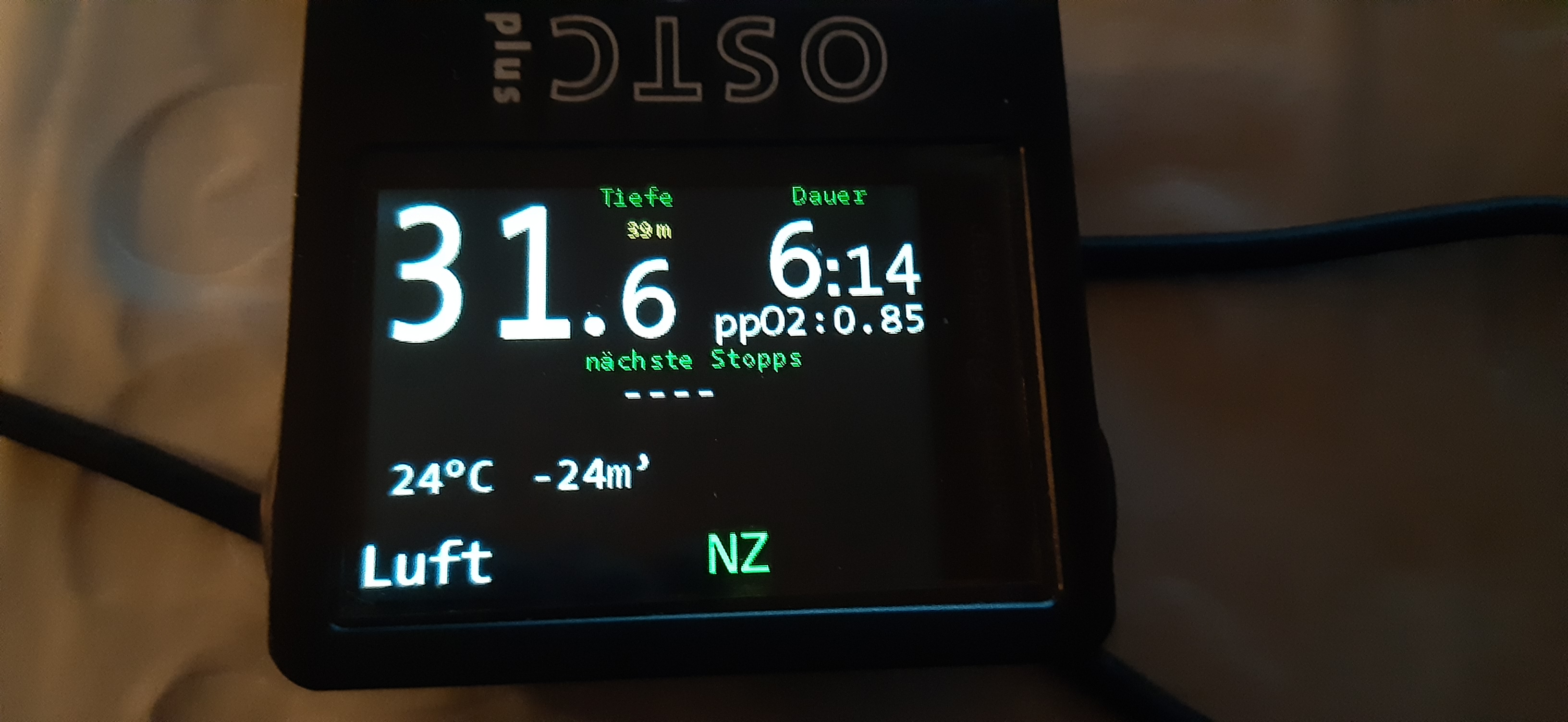

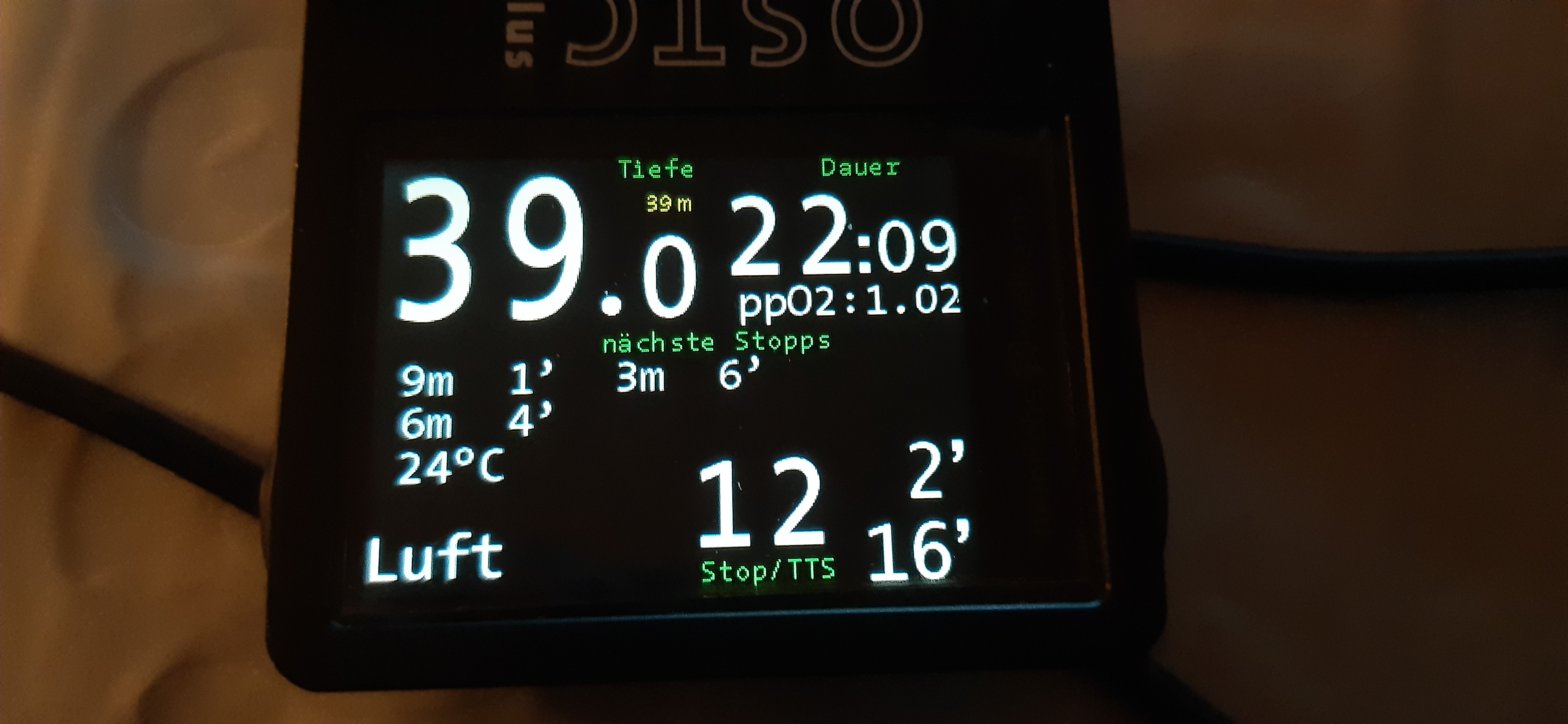

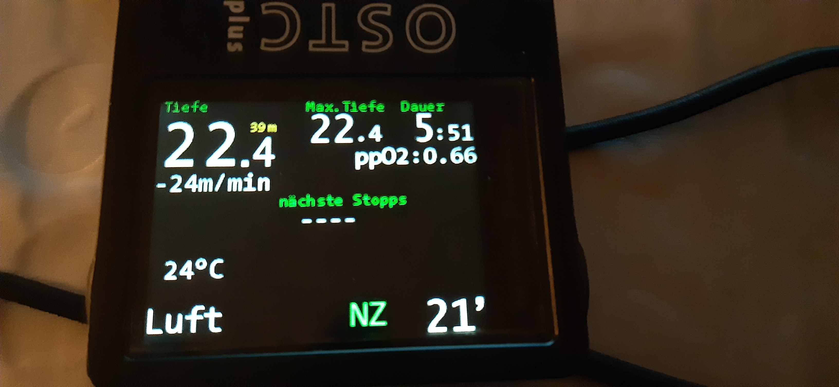

hi guys
I installed the beta1 today. the menue seems to me more intuitive and better structured. the only thing I found (tested it outside the water - sorry, was diving yesterday) was that the NDL
in the bigger layout is gone
, stops ar shown
(I used the simulator) - maybe take a look at that

thanks a lot - could reproduce & will fix that!
