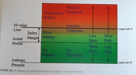

If I look at the figure attached (from “Deco for divers” from Mark Powell we should avoid total supersaturation.
Is it true that you generate a warning when you are already more than 100% supersaturated, and is this on purpose? Should the limit 1 not be used, or a margin from that (0.95?)

Basically, HW and the OSTC dive computers try to stay as close as possible to the ideas and limits that Bühlmann developped, refraining from adding some own-brew additions and safety pads. So when Bühlmann states 100% is the limit, and with GF mode switched off, the OSTC will give a warning at 101% supersaturation: a GF warning message is shown and the depth will be colored in red. That is the main warning for crossing the M-line.
Looking closer, if theory says 100% is (still) ok, it must be figured in that a practical dive will have short excursions to 100% + a little % for a little bit of time. As the picture shows, there is a continuous transition between "safe" and "DCI". For that reason, the OSTC accepts excursions beyond the 100%, with warning give but also revoked once the dive returns inside the Bühlmann Limit again.
