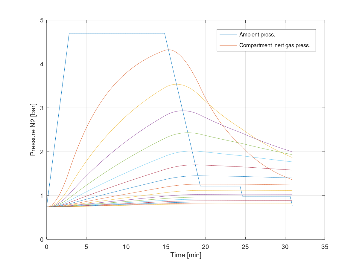

I calculated a profile according to Buhlmann (no GF yet) and it seems that the pressures in some compartments exceed the allowed pressure.
This is for a profile that is recommended (simulation-mode) by the OSTC plus computer. Also when I put the dive in Subsurface, it recommends a profile that is very similar to the OSTC computer.
So basically since both computers give very similar results which both result in pressures larger than allowed, I thought there may be an error on my side.
Thus I looked at the code (https://bitbucket.org/heinrichsweikamp/ ... /p2_deco.c). Only difference is that you do not integrate over a small delta-time, but use the p2sec table (with basically pre-integrated values between two seconds). When I use your method (which is much quicker than using a delta-t =0.1 seconds when integrating of course ) I get the same results.
Basically it is good that using the integral dp/dt = -log(2)/halftime*(p(t) – pamb) or -(p(t)-pamb)*e2sec give the same result. But the same results is still that pressures for some tissues become larger than allowed (super-saturation).

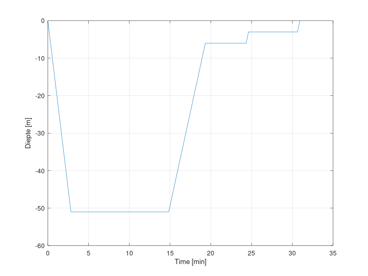

I made an example and described it in the added pdf document: It concerns a dive on air to 51 m, 12 min bottomtime, first deco-stop on 6 meter (5 min), second stop on 3 meter (6 min). No gas-switches.
Could you be so kind to help me, and calculate the pressures in the 16 compartments when just arrived at 6 meter and when arrived at 3 meter. Since I use your calculation-method I think the results should be the same.
I have the results and the complete code in an attached Word-file (code can be copied and saved as an m-file to be used in Matlab or Octave, since you program C you can read it ). Also my results (table) with tissue-pressure at these depths is shown. @6 meter than compartments 2,3 and 4 are supersaturated. @3 meter compartments 3,4 and 5 are supersaturated.
Since the code is quit simple (just calculate the tissue-pressures and plot them in graph with Buhlmann-curve) I am really puzzled .

PS the supersaturation has also been calculated for the 3m stop and for tissue 4 it is 1.17 . More than allowed according to the Heinrich Weikamp SW.
on air dive with Buhlmann (no GF) then supersat = 1.17 is proposed

Hello Ralph,
The gravity constant what you mention is simply the METER_TO_BAR constant. I used the same parameter as in the Heinrich formula (1/10.19716)
Also I used ppWater = 0.06270 (same as in the code)
So this is not different.
I calculate with dt = 0.1 second (And also an example with the 2 second table from Heinrich) so this accounts for any ascent speed (In the added pdf you see the profile, I ascend also with 10 m/min, and account for all the travel time), still I get supersaturation 1.17.
You say it is obvious that the tissues pressure change is quit large at ascent. Yes, this is not my point. My point is that I dive with > 1 supersaturation is proposed which is dangerous.
