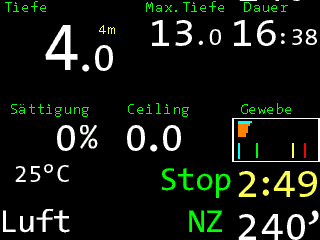

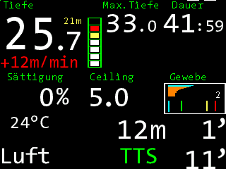

Here's a screenshot of the safety stop and a real deco stop. You can see the difference clearly.

Thanks Matthias,
I saw that the deconstops are displayed numerically compared to the safety stop after doing some simulated deco dives.
I just wanted to confirm that I didn't mess up any settings.
