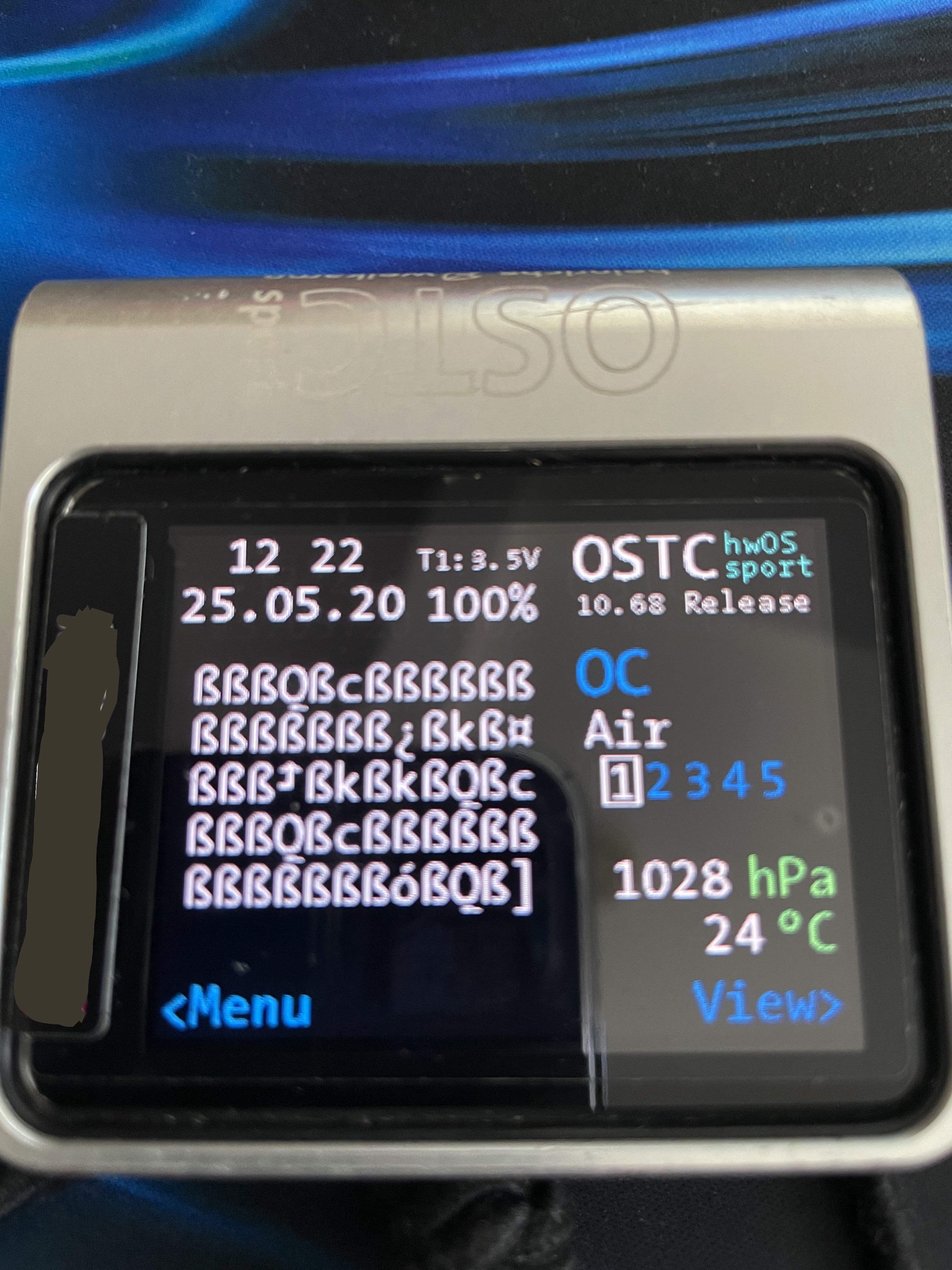

I just updated the firmware on my sport and get a strange main screen, see photo. I tried reloading the formware but still the same, any ideas?

That's the "custom text" which seems to have not been retained from the old firmware, probably because you made a bigger jump in the FW versions. You can simply replace it by your favorite custom text via the 'name' function in OSTC companion or other OSTC tools.

ok thanks, but I only updated from 10.67
all done now thanks Ralph
