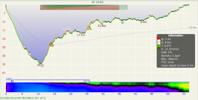

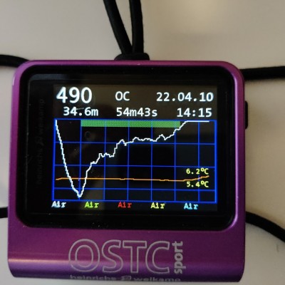

I did some dives with my new OSTC Sport (running hwos sport 10.73) with fairly conservative settings, GF 50/65. On the first dive it was fairly close to my Garmin watch with the same gradient factors. However, on the 2nd dive I had to get much shallower for the OSTC to start counting down the deco time.
On the first dive the OSTC is pretty close to Subsurface's ceiling and the Garmin is in the same ballpark.
On the second dive the Garmin and Subsurface are pretty close:
The OSTC is much slower though. It doesn't end the deco until Subsurface reports a surface GF of 60.

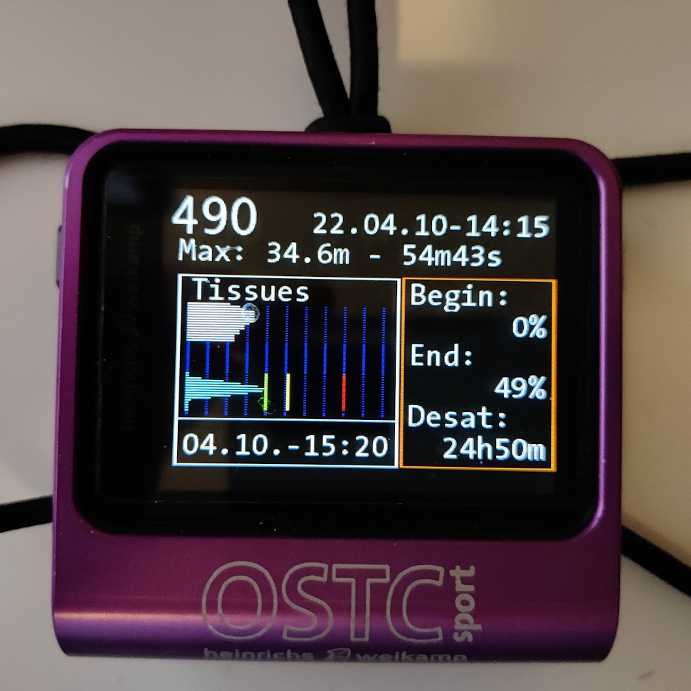

Is this the expected behavior or is something off for the 2nd dive? Did I just accidentally end up with a profile where the OSTC didn't think I was off-gassing the leading tissues, while the Garmin and Subsurface just happened to end up on the other side?

Yea, as jb2cool says. What I am concerned about is the big difference compared to the two other Buhlmann implementations for the 2nd dive. I had another dive a couple of weeks ago which showed similar behavior, but on that dive I had difference settings on the dive computers and there where other changes, so wanted to make a more controlled test.
The Garmin watch also uses the real surface pressure and I think Subsurface uses the pressure from the OSTC log when doing the calculation. The surface interval is taken into account and you can see the initial nitrogen load in the heat map under the depth graph. In this case the Garmin data is slightly deeper on average, even though they have the same salinity, so Subsurface ends the deco slightly later for that data compared to the OSTC data.
I have a Suunto computer that is much more strict on the 2nd dive, which makes it really hard to have conservative settings on the first dive and I want to be sure that nothing like that is going on here.

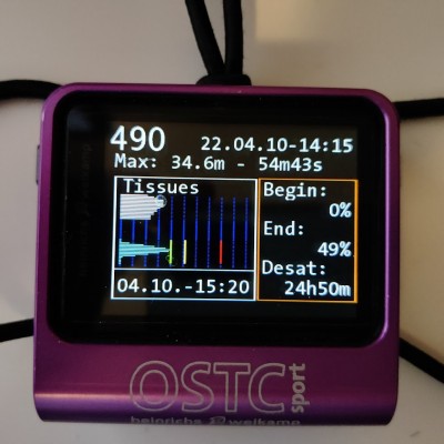

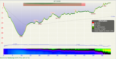

For reference. On the first dive Subsurface calculates 64 as surface GF when OSTC ends the deco, and on the 2nd dive the surface GF is 60 when deco ends.
On the dives I did a couple of weeks ago I used 50/70 as gradient factors. On the first dive Subsurface calculated the a surface GF of 68 when OSTC ended the deco, and when the deco ended on the 2nd dive Subsurface calculated a surface GF of 64 (very close to 63).
On the most recent dives the surface pressure was 1000 hPa according to the OSTC log and on the other dives it was 1052 and 1058 hPa, so even if some constant is assumed it's not going to make a big difference.

if I got it right, the issue seems to be, that the OSTC shows a longer "red bar" for the deco .
btw what are the saturation/desaturation settings of the OSTC? if they are not 100/100 that could be the explanation.

And Ralph, I still think the difference here is quite big. On second dive, when Garmin and Subsurface thinks the deco is cleared, the OSTC still has a 5 min stop at 3 m and the @+5 also shows no difference in TTS, so something is different in the off-gassing.
Subsurface takes the tissue conditions from the previous dives in the log into account, and the Garmin is always on me and tracks the same information. If I remove the first dive from the log then Subsurface calculates a surface GF of 52 when the deco is cleared instead of 60.
>1050 hPA might be unusual high, but it only has minimal impact on the deco and it makes it slightly shorter, not longer. In the dives above the surface pressure was 1000 hPA though, which is well within the norm.
The Garmin logs roughly every second and difference that Subsurface sees between the OSTC and the Garmin log seems to be a reasonable difference for the change in sampling interval, a few minuted difference in when it thinks the deco is cleared, not a >15 min difference.
It's still possible that I accidentally triggered some weird threshold and if I just moved up 0.5 m then the OSTC would off-gass the tissues that affects the ceiling, but since I saw this behavior on both dive days that I used the OSTC I thought it was odd.
Yes, gr3ywolf, the issue is that the OSTC shows a longer red bar. The saturation/desaturation settings are 100/100.

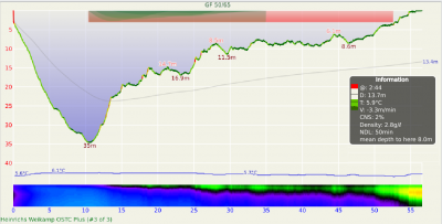

Yea, I think there some real misunderstanding with the data I'm trying to present. Might be that you're not familiar with how Subsurface displays the information. Or something else is wrong (I do notice that the order of the images is wrong when watching the thread under the reply editor compared when just watching it normally).
There are 3 graphs in my first post. The first one is from the first dive. Since I only could attach 3 images i used the OSTC, but the Garmin looks very similar. The red bar is the deco ceiling according to the dive computer, it ends at around minute 45. The green bar is the deco ceiling according to subsurface, it ends just before, at around minute 43. These are all reasonable differences. If a do a plan like 30 min at 30 m on Air on the Garmin and OSTC they end up with very similar run time and stops. The calculations for the first dive is not in question, they are all within the same ballpark. It's the 2nd dive that is the issue.
In the 2nd graph you can see Garmin log for the 2nd dive. The dive computer ceiling ends at minute 35 and the one calculated by Subsurface ends at around minute 37.
In the 3rd graph you can see the OSTC log for the 2nd dive. There the dive computer ceiling ends at minute 52 and the one calculated by Subsurface ends at around minute 35. Here is the log according to the OSTC itself:
During the dive,as the Garmin was just clearing its deco obligation at around the 35 min mark, I was at a depth of around 8-9 m and the OSTC was still showing the same 5 minute stop that it had counted up to earlier during the dive and the @+5 showed the same TTS. According to the log it seems to take a bit more than 5 minutes to decrease the deco time by 1 minute, so it is off-gassing, but not fast enough for @+5. Very much slower than the off-gassing that Garmin and Subsurface calculated though.
I don't have access to a Shearwater, but if people have done repetitive dives with it and the OSTC and compared to the Subsurface calculations, then it would be very interesting to see. With less conservative settings you could compared the saturation at the end of the dive, instead of cleared deco ceiling, and see if it matches up. I got distracted when surfacing so only have the saturation from when the log was saved 10 minutes after surfacing. If it would turn out that Shearwater and OSTC largely agree and are this different from Subsurface and Garmin on the 2nd dive, then I would really like to hear about it.

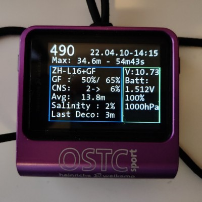

The OSTC will clear the last deco stop when the ascent calculation yields that on arriving at the surface the leading tissue will be at GF high. Sometimes you may read that the leading tissue reaches GF high at the last stop, but what is wrong because when doing a linear projection from GF low at the first deco stop and GF high at the last, there will be a leading tissue's pressure > GF high at the surface.
As your dive seems to be a deco dive, with one stop only at 3 meters, your GF low of 50% will have locked onto the 3 meters stop and your surfacing was controlled by the GF high of 65%. As you stayed at 8-9 meters if i remember right, the extra 5 to 6 meters do slow down the offgassing which explains why the @+5 mins do not give a smaller number. The TTS always assumes you are starting your ascent now (or in @+X minutes for that 2nd deco calculation), i.e. go up to the indicated 3 meters in this case and then follow the issued deco plan. As you stayed deeper, you pushed the deco clearing with you towards later times. I don't know how other Bühlman with Gradient Factors implementations handle the case when the 1st stop is equal to the last stop regarding GF low / GF high application, but above is how the OSTC does it and it yields a smooth transition from NDL to deco.
This probably does not directly answer your questions, but maybe it provides some more bits into the understanding.

I wrote to "NDL" dives in my reply to gr3yw0lf since I thought his comment on my choice of gradient factors was pushing the discussion in the wrong direction. No recreational dive computer would consider these dives deco dives on default settings. According to the PADI RDP there would be a mandatory safety stop, I don't know if that makes it a deco dive or not, it doesn't really matter in this case.
I picked 50/65 as gradient factors since I knew that I then easily would get a 3-5 minute stop at 3 m and be able to see when that cleared on the different computers. So, according to the OSTC (and Garmin in this case) the dive was a "deco" dive. With this data I can then more easily compare the different Bühlmann implementations in Subsurface.
I could set 85 as GF high and there would be no deco. According to Subsurface I briefly reached a surface GF of 80 during ascent from depth but it was down to 79 by the time I reached 20 m. However, then it would be harder to compare the dive computers, especially afterwords, since the tissue data isn't available in the log.
The bar at the top edge has two sources. The red part comes from the dive computer log. The green one is calculated by Subsurface on the data in the log + it takes into account previous downloaded dives. You can see the the ceiling for individual tissues as curves earlier in the bar as darker shades. They quickly go down to almost 3 m and then slowly go back to the surface, with different tissues having the lowest ceiling. The green 3 m bar continues until all ceilings have reached the surface, but if you hover over the graph in Subsurface the actual deco calculation in the information window shows that deco is cleared a few minutes earlier and the target GF high will be reached when surfacing.
The question is really about tissue loading and off-gassing. You write that OSTC will clear the deco when it thinks that the target GF high will be reached upon surfacing. In the second dive this would happen at around 32-35 minute mark according to both Subsurface and Garmin (once I get to above 10 m it takes about 10 minutes to clear the 3 minute deco) , while for the OSTC it takes until minute 52 to reach the same GF high. So what I'm wondering is why the off-gassing seems to be so much slower at 8-10 m, or the tissue loading so much higher. It could of course be that both Subsurface and Garmin are way too fast in off-gassing or too low in tissue load, but with the data I have it's OSTC that stands out.
